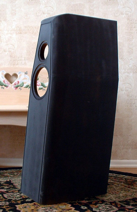

2 slightly more unconventional designs that may be worth investigating are the original Wilson Benesch ACT 1 speakers and the Impulse H2's.
Both are British designs and are no longer in production, but both used conventional drivers and were very well received.
The Wilson Benesch speakers used standard Scanspeak drivers in a 2.5 way reflex loaded system. The two bass / midrange drivers were 18W8545's with a 9300 tweeter (I think). A lot of the success was undoubtedly due to the curved composite panels in the cabinets which reduced colouration to negligable levels. Attention to detail with crossover component maching and general assembly also contributed to their success.
I was fortunate enough to hear the speakers in WB's dem room, and they were stunning, both in terms of detail and imaging.
The impulse H2's were a totally different animal. They used Seas and Focal drivers, and although the specific units used are no longer in production, there are very similar replacements available. They were horn loaded, but I suppose that they could be more accurately described as horn assisted. The horn was very simple in concept and was little more than a diagonal panel that went from the front bottom edge of the cabinet up towards the top back edge. The horn probably accounted for less than half the volume of the cabinet, with the rest effectively being the chamber behind the bass driver. The bottom of the cabinet was open and this was the horn mouth. The speakers therefore had to stand on short legs so the horn could breath. It basically broke just about every rule of horn design but supposedly worked extremely well.
There is very little information available on these speakers, but some can be found here.
www.acoustica.org.uk/impulse/impulse.html
I have not heard the Impulses but they got some excellent reviews. If anyone has any info on either of these speakers I would be very interested, and would be quite keen to have a go at producing a pair of clones.
Steve.

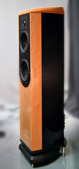

The Usher CP-6371 looks remarkably like the old Wilson Benesch designs, with the specs being scarily similar as well. I agree that these would be ideal to clone and there are also a number of cabinet options that can be used depending on the builders skill and pocket.
Wilson Benesch's latest incarnation of the ACT speaker utilises a welded steel skeleton wrapped with a carbon fibre shell. Details are at -
www.wilson-benesch.com/whitepapers/actwhite.html
There is an interesting article on the building of the M1 speakers here, which use the same mid / woofer and tweeter as the WB design. This gives plenty of detail of the build, complete with crossover values and schematics. It would be quite easy to incorporate an additional woofer in the same configuration as the WB or Usher designs.
www.speakerbuilding.com/content/1021/
Photo of the WB ACT speaker below.
Steve.
