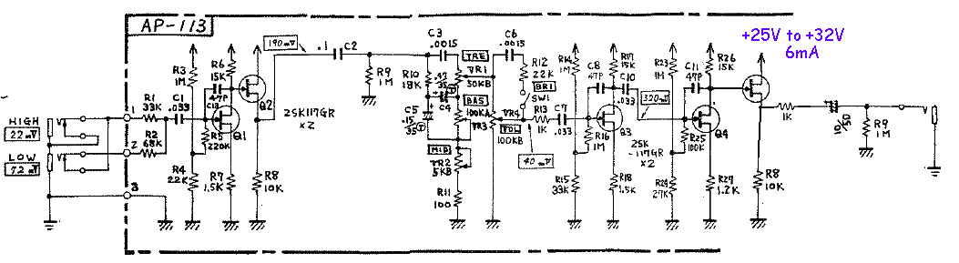

Anyone have thoughts on this? Don't want the distortion or amp section, just the clean guitar preamp with volume / treble / bass / mid tones controls...

Looks to be four 2SK-117 and a single 2SC-1815? Connection to 5 / 7 is a bit confusing...

5/7 cross-feed two input to two power amps. If you want the one channel, ignore this.
Yes, the JFET RJC is one of the sweeter amps ever built, and I do not think the opamp ones are just-as-good.
Build the plain top channel, sections involving Q1 to Q4, up to the left side of R29, place the output jack there.
Personally I would add a unity gain Buffer , a single 100% NFB Op Amp is perfect for that, so output is lower impedance and can drive longish cables and most any Power Amp input.
You will need to build a clean 27V (nominal) supply to feed the preamp, anything from 24V to 30V will do, and if you add the Op Amp buffer (a single TL071 is enough) you can also feed it same single supply as the rest of the preamp, no need to get +/-15V just for it.

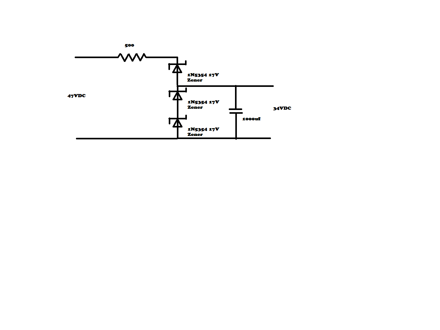

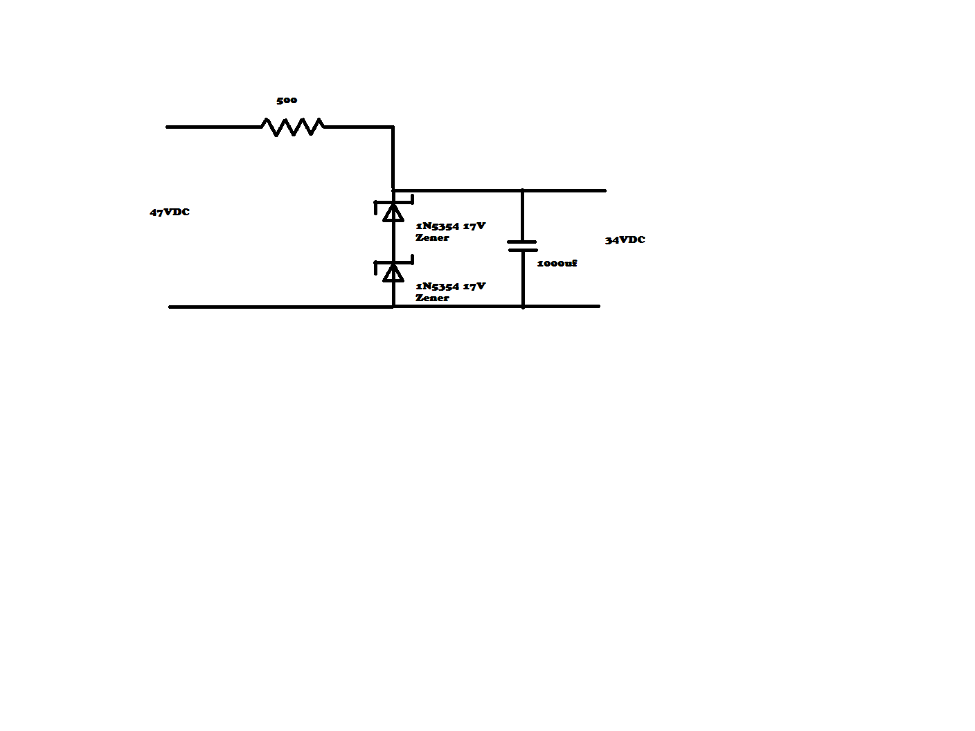

Looks to be a pretty basic design... I should have something bread-boarded in a jiffy. Just gotta get up with Digikey and make an order...Mybe couple this pre onto an ICEPower 200ASC as it has a 47VDC output pin....add a couple zeners and I should be able to get the 27V and 43V for the pre...

JM - leave the R29 and R33 out? I was going to terminate after R33 with input to Amp...
I can also add your buffer with another "copy" of Q2 also, correct?
Agree with PRR´s buffer, too much in a hurry to open the Service manual now but if R29 and R33 are the channel mixing resistors yes, they are not needed now.
As of FET replacements, given that their characteristics vary a lot from unit to unit, best is to buy a few extra and try them, leave the ones which work closer to expected and save poorer ones for non critical stuff ... such as unity gain buffers.

OK, so I left the three gain stages 2SK-117 GR, and put in the 2SK-170 GR in for the two buffers...
Just gotta make up the tone stack / volume pots now...
Built the pre and it sounds about as clean and quiet as I ever heard. Me likes!
Only one issue - too much GAIN!. I know I have a 1 Meg Linear volume pot, and have a real hard time getting past 1 with bleeding ears... I don't think changing it to a Log pot would do me any good with all that gain. I am thinking of pulling Q4 or modding Q4 to reduce some of the gain...any thoughts?

The "Audio taper" pot will get you off "1".
This preamp is made to go to a POWER amp, not an effects loop.
Yes, in many setups Q4 may not be needed/wanted.
