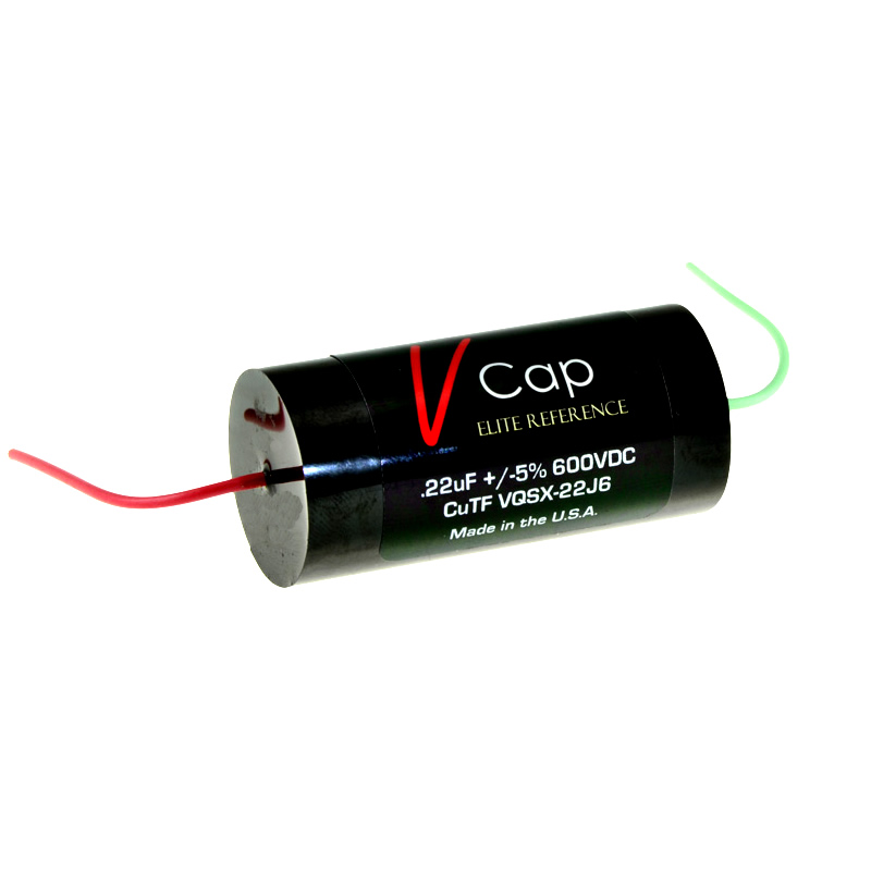

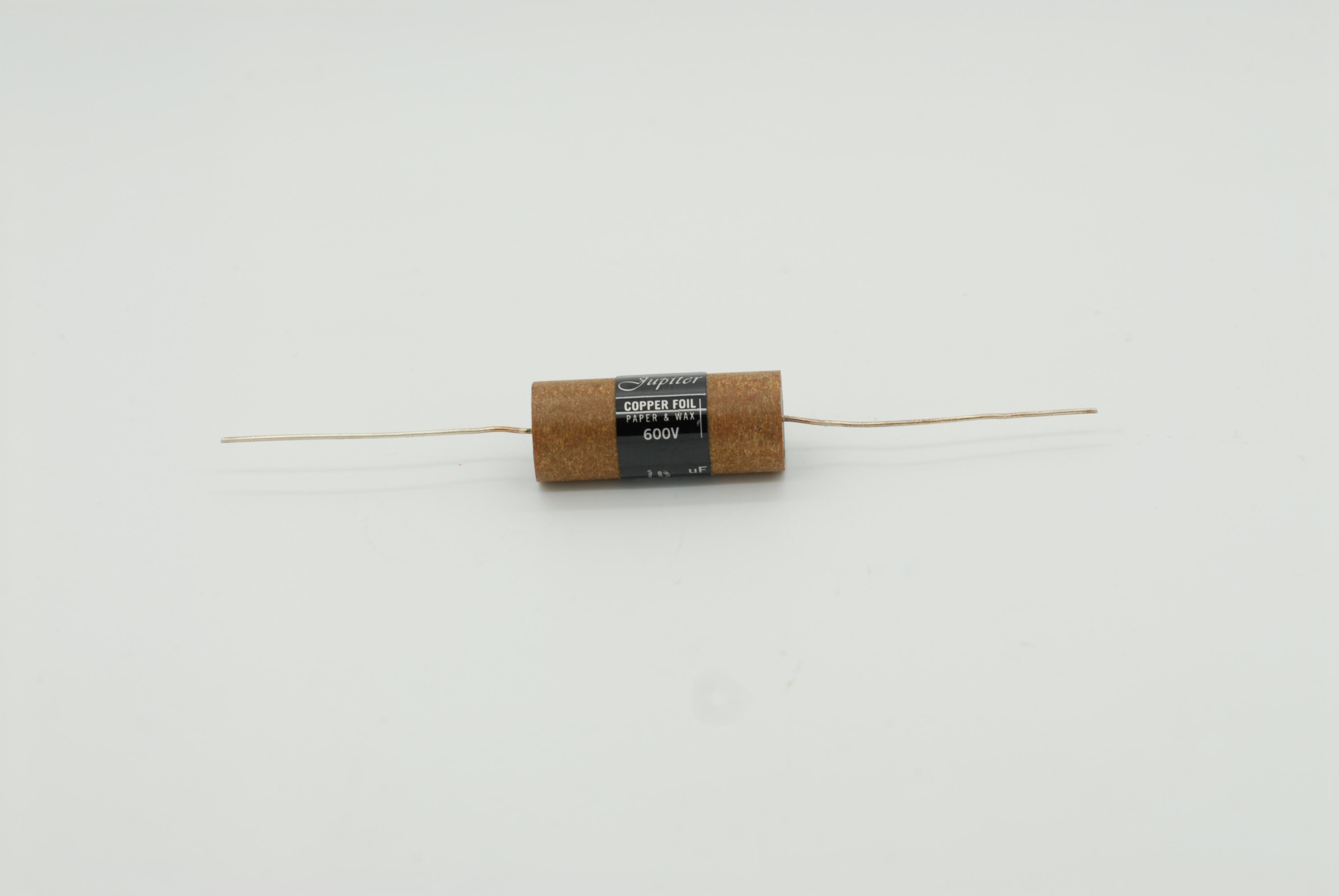

The coupling caps (0.15uF) are of course critical. What do you intend to use?
.15uF versions of these:Are they not pretty much the same? Don't see much point in replacing those.
