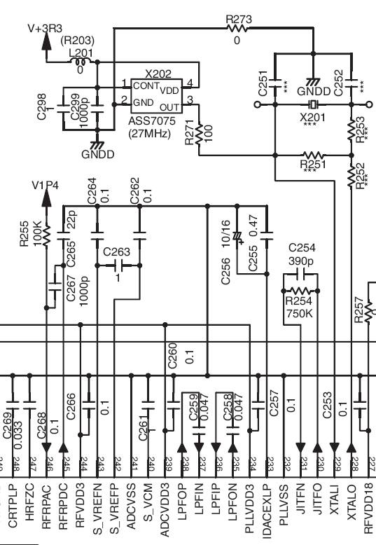

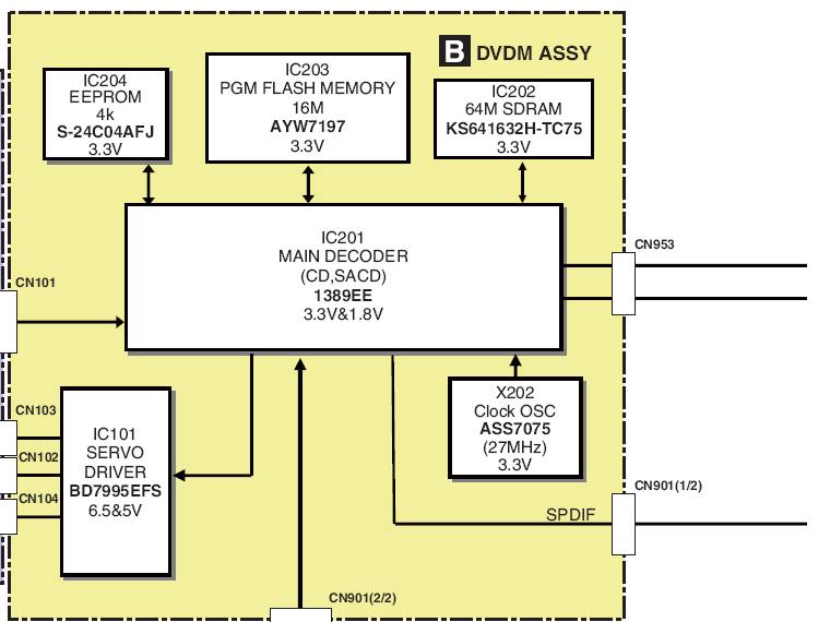

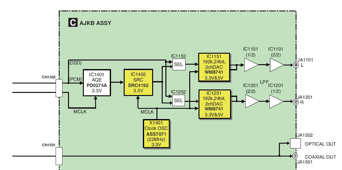

Just got the Service Manual of Pioneer PD-D9 for clock modification, I found 2 OCX of 27Mhz (for MT1389EE Chip) and 22Mhz for SRC and MCLK(PCM only) for DAC. This SACD player employed 2x WM8741 DAC chip, i suppose this player using DSD direct mode, so if I want improvement on SACD playback, I should modify the 27Mhz one, while improvement for CD playback, I should modify the 22Mhz, is it correct?

The SRC 4192 is doing the reclocking and upsampling of the PCM signals. DSD signals are bypassing that SRC and are going straight to DAC.
So, for SACD it is necessary to upgrade the 27MHz clock. For PCM the 22MHz is the main one.
