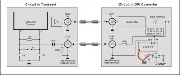

My sound card, a RME DIGI96/8 PAD has an add-on module called the word clock module (WCM). The function of the WCM, among other things, is to sync external devices (i.e. a DAC in my application) so that jitter is thorwn out the window (somthing like that). My DAC, the AN DAC 1.1 kit does not have a separate clock signal input or output to allow for this feature of the sound card to be utilised. I am thinking rectifying this situation but am not entirely sure how to go about it. Here is my proposal :
1) Take the M Clock output of the CS8412 receiver ship in the DAC (pin 19) & use it to form a clock out signal & feed to the WCM of the sound card
or
2) Use a precision clock module (e.g. LC clock, trichord clock, Elso clock) to be placed in the PC & use it to feed the input of the WCM.
Do you think I am nuts ? Or the above proposal is something that can work. I am inspired by the following diagram taken form LC audio site.

Word sync inputs don't attenuate jitter, they simpley synchronize two frequency domains. If you want a low jitter system, you need to start with a good master clock and feed that into your DAC. Then feed a divided word clock dervied from the master clock into the word sync input of the sound card. This way you won't need a SRC in the DAC.

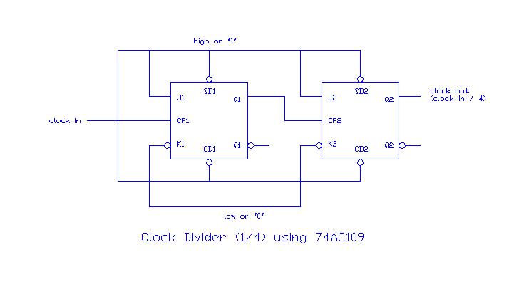

Ok, after much huffing & puffing, searching & seeking & copying, I come up with a clock divider circuit to divide a clock signal by 4 so that :
1) I can use an after market clock of 11.xxx mhz to feed the WCM of the sound card
2) Use the divided clock of 2.8xx mhz to feed the DAC chip of my AN 1.1
What do you think ? Will this work ?

joeling39 said:Ok, after much huffing & puffing, searching & seeking & copying, I come up with a clock divider circuit to divide a clock signal by 4 so that :
Wordclock runs at the sample rate and in the case of the WCM is 44.1/48KHz or 88.2/96KHz. RME do not seem all that keen on Superclock which does run at 256Fs.
The four CS4812 signals SDATA,SCLK,LRCLK(FSYNC) and MCLK are all synchronous in the case of the AN1.x. Even though MCLK is not used in this case SCLK,LRCLK and SDATA are all in sync with it which means they are in sync with each other. An external SCLK signal would violate this.
Back to the drawing board. Not a good idea and it will not work well it the unlikely event it works at all.
