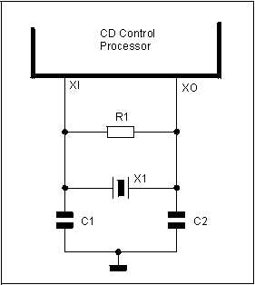

I have a sony CDP-XA20ES that have had an LC audio clok upgrade. The clock module has now been removed and i need to restore the original clock or make a diy clock upgrade. In the original clock there is a 45,158 HNz crystal and a pair of small capacitors. C1 and C2 Does anny of you know what the value of the capacitors should be? I vould also like to make a DIY clock upgrade - have anny of you seen stuff like that on the web?

Hu Webercarbmann,
In my Sony the resistor is 10k and the caps 10pF. In the CDP-XA30 these values are:....the same.
But if you do want to install the DIY KWAK-CLOCK upgrade you have to remove the resistor and the caps.

If you choose to restore the old clock then for sure use 1Meg resistor as hifi suggests... It improves the sound.
It is totally strange why Sony uses so small resistors in this place. It actually makes a clock a lot worse (more jittery).

Hi ergo,
i did some work on a new clock for my sa-cd; the crystal is a 3. overtone, so if you load it not (or 1meg), it resonates at 15 Mhz, with a 3k load (or so) it resonates at 3. harm, 45.1mhz, thats why they do it this way...cheaper than complex l-c circuits;
i work on a colpitts 3.overtone clock at the moment if you are interested let me know.
alf
