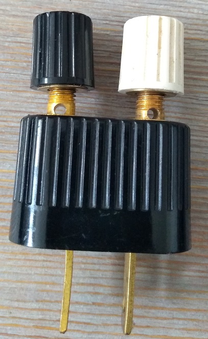

- 3 prong ac brick for laptop may cause ground loops leading to issues. Replace with double insulated power brick

• 3 prong ac brick for laptop may cause ground loops leading to issues. Replace with double insulated power brick

Ideally it should be only one 3-pin plug in the system with a ground connected to your DAC (it means only one Y-capacitor), it is not always possible. A traditional isolation transformers bricks can be used, low power transformers are not expensive.
Aslo check with a multimeter whether your IEC grounded power cables have proper wiring. I found one cable with reversed line and neutral pins.
Yes, it helps. I think you mean SMPS PSU (laptop brick) that do not have earth connection. Even with that you still need to fiddle with the plugs. My laptop has 2-pin Euro plug and to remove ground loops I had to reverse position of the plug. Integrated amp has also 2-pin Euro plug, but a DAC and external monitor have IEC 3-pin plugs. With two devices you have four combination to play with. 🙂• 3 prong ac brick for laptop may cause ground loops leading to issues. Replace with double insulated power brick
