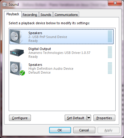

Is your USB DAC a default playback device?
The easiest way to deal with unwanted system sounds it to not use it as a default device.
As you see on the attached screenshot, there are two USB sound devices, but a default sound device is the internal HDA device. Your systems sounds go to the default device (your system speaker in this case).

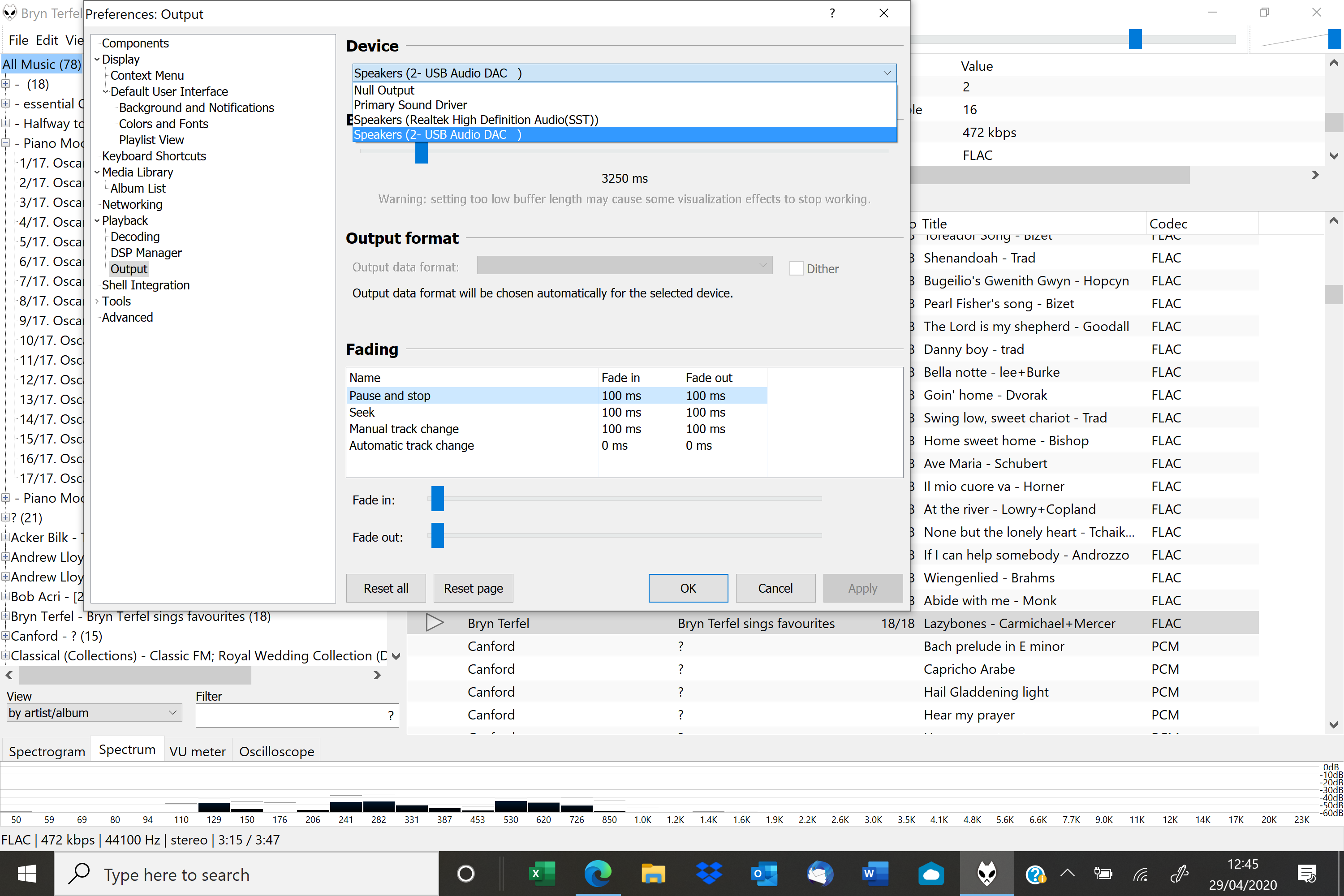

I haven't completed yet but have set up as attached, no wasapi or equivalent because its a bit complicated for me, more detail apparent than media player was doing, and.....the switch clicks don't happen now! - great start thanks
Whooow! You are very good with Foobar already! 🙂
Clicks are gone, but sound will be even better when you install WASAPI add-on. As for now sound is still going through the Windows mixer and is resampled to the value given in the Windows Sound properties. It is better if sound is not resampled, but played with a native speed.

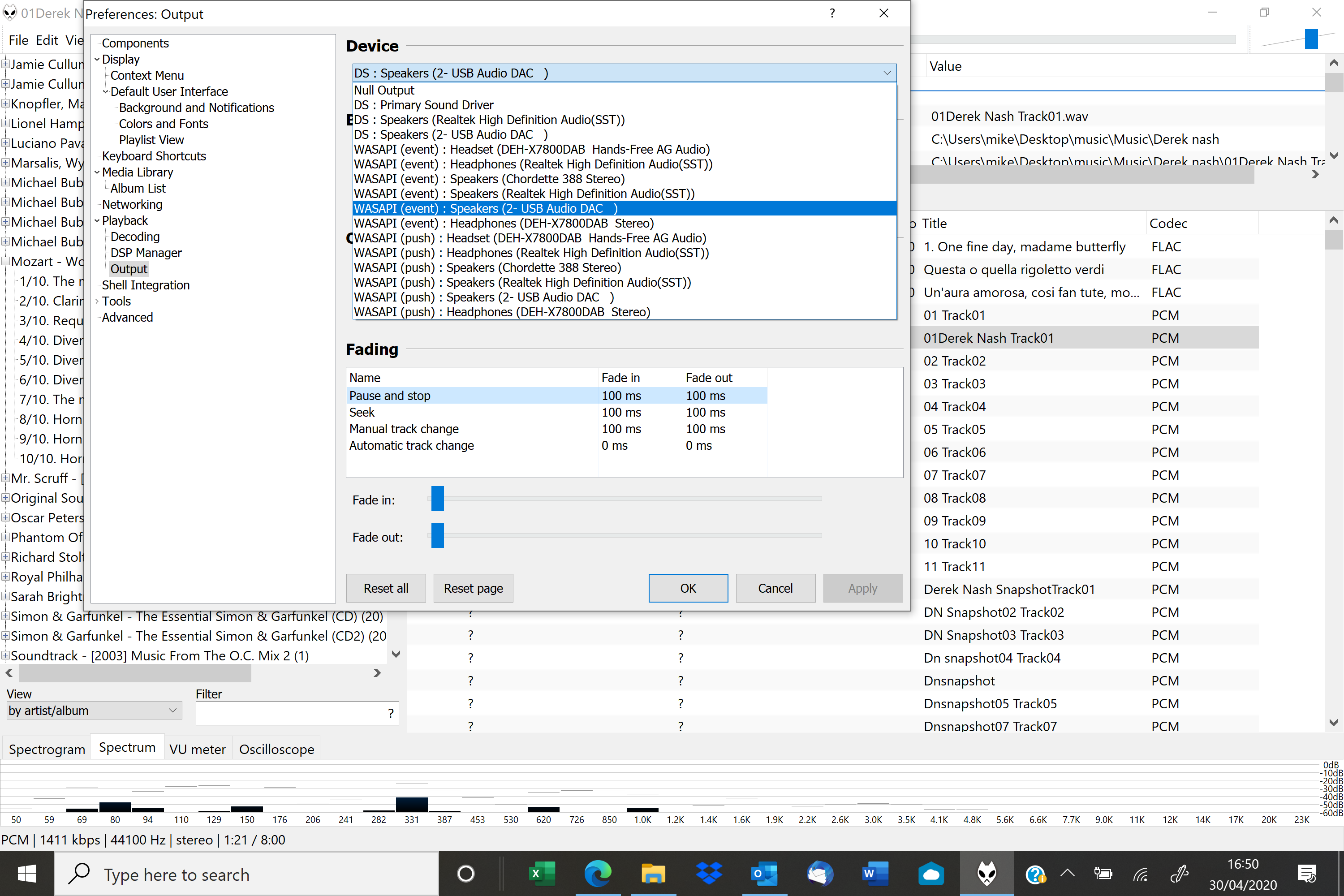

Well... i took the plunge, installed WASAPI, and i have so many choices now i am not sure, here attached a screen shot, i didnt click any more! could you kindly tell me the next moves, BTW FooBar for Dummies disappeared now!!

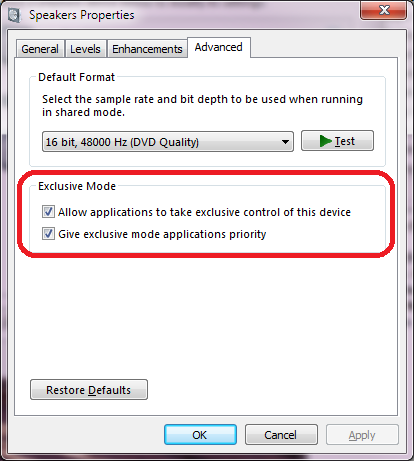

Well, you have only two bit-perfect choices for this DAC: WASAPI event (highlighted) and a push. Go to the Advanced -> Playback -> WASAPI and tick a box "High worker process priority". Then in Windows, find a similar settings, I attach a screenshoot from Win7.
It is also said to set levels and a balance 100% and disable all enchancements. When it is completed, you can start playing.
