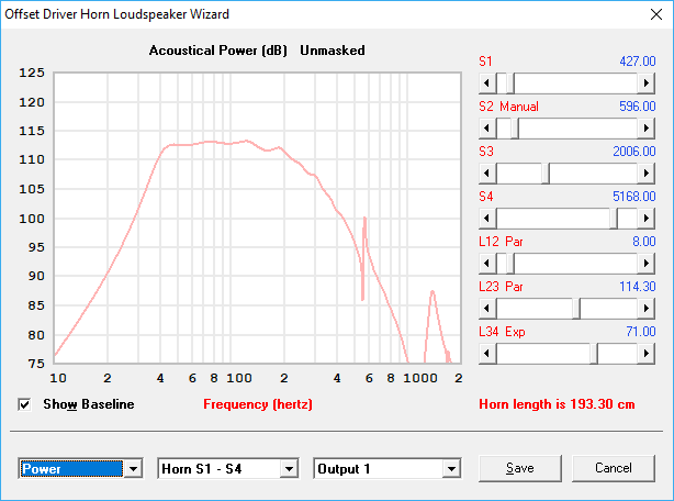

I'd done a Hornresp analysis on the EL36 some time ago. They were quite capable of reaching 40 Hz, when used as I believe it was suggested - a pack of four. Of course the end result of stacking four of these together probably couldn't be considered as "small"... 🙂
The attached sim is with 4 EL36 cabs loaded with B&C 18TBX100 drivers.

It is likely you were impressed with just how much output was produced by a single cabinet and how clean/defined it sounded compared to a reflex. Both of these things are what horns are known for, traditionally bass horns don't go that low but when your pants legs are flapping as you stand there 10ft in front of some you sure do get the impression that they do.
