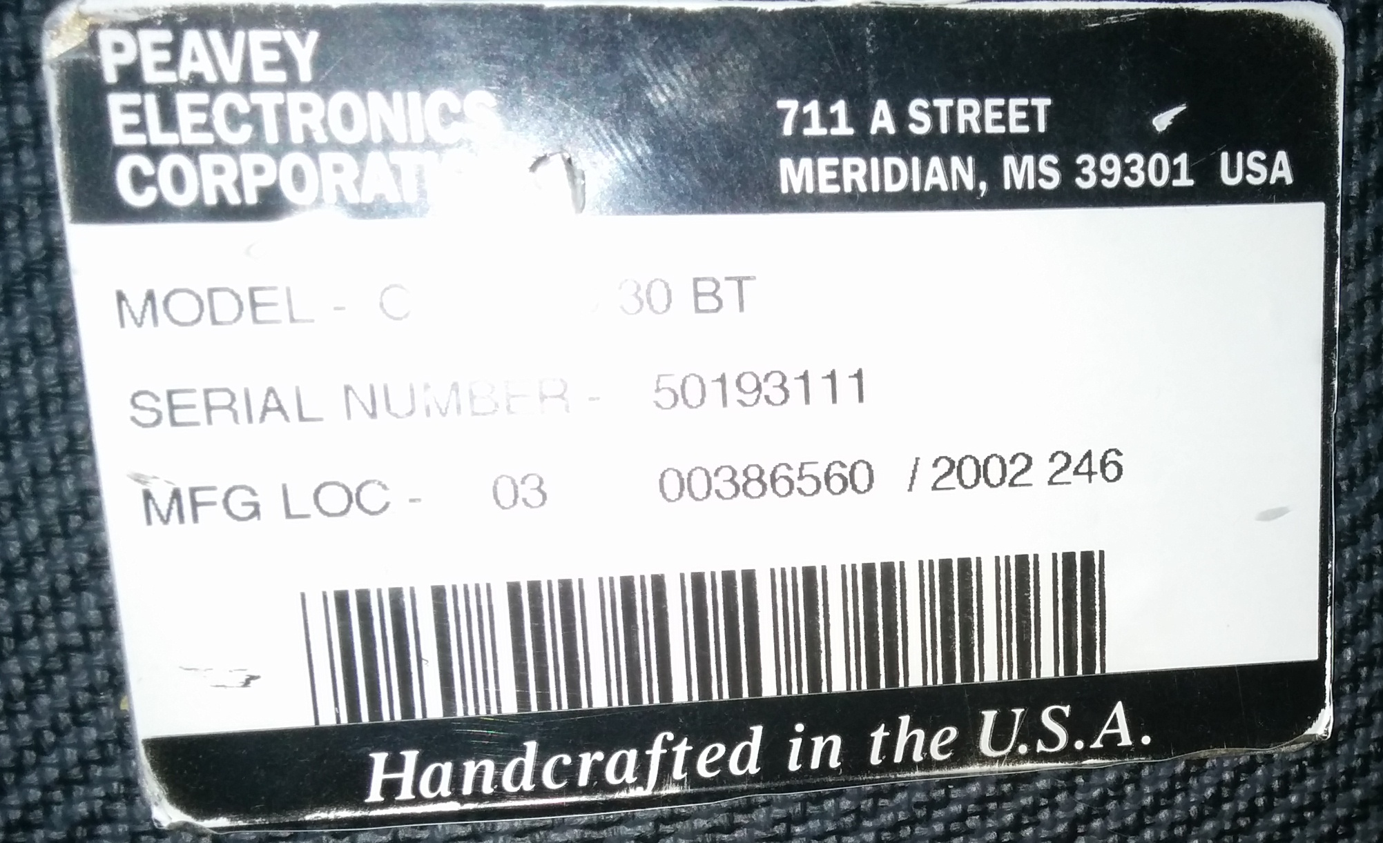

I have a Peavey Classic 30 BT, I believe its a 2002 model.
The amp uses a 16 ohm speaker and there is a jack for an external speaker.

Here is the schematic and a pic of the ID plate.
There are both 16 and 8 Ohm taps available, so wire the plug for the 8 Ohm speaker. It's pin 3 on jack J4.
