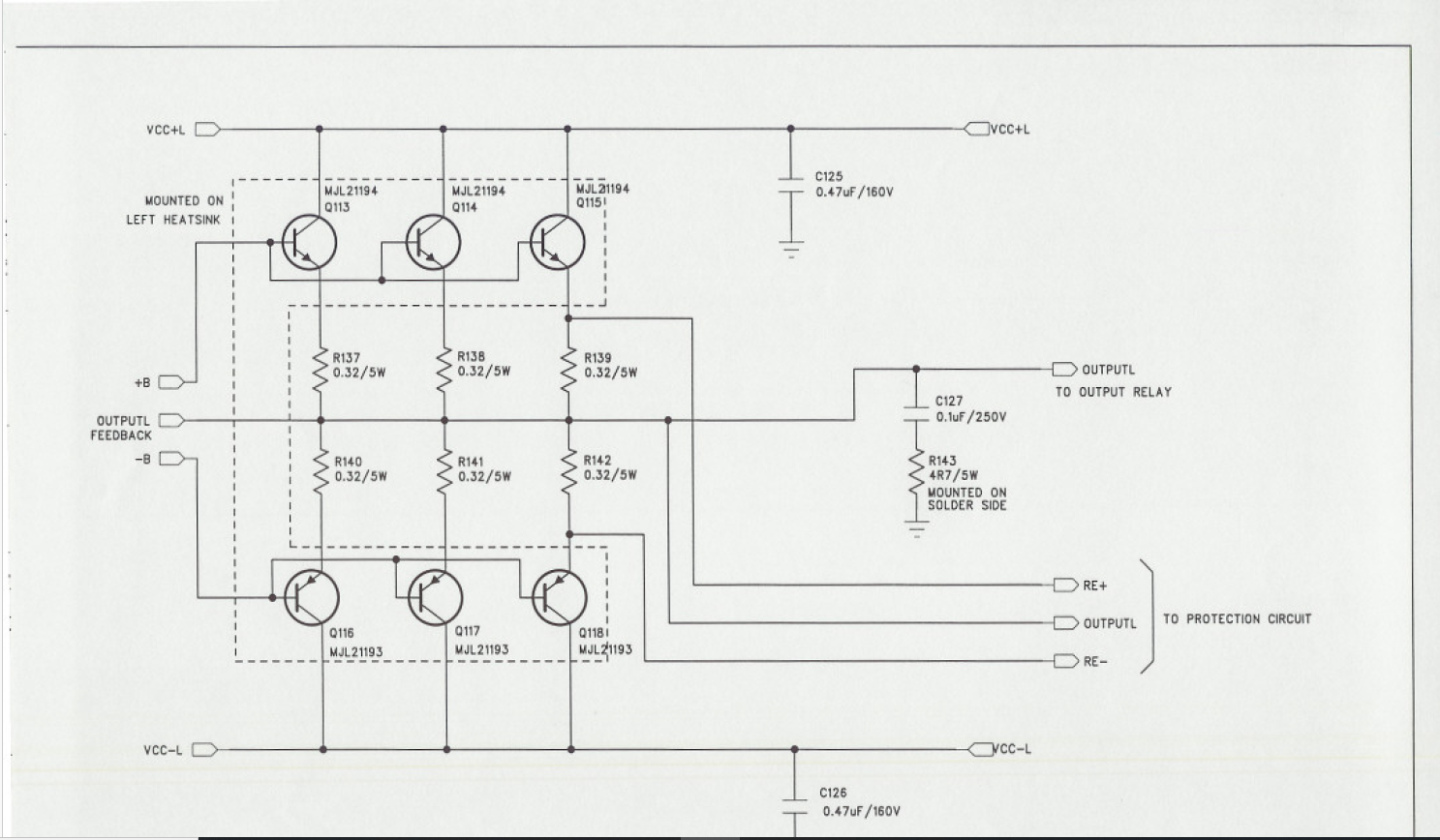

Classe ca 150 swap output transistors to MJL21194G from 2SC4029
Hello every one
I have a Classe ca 150 with some burned output transistors and also have some new MJL transistors laying around. is it just to swap out the 2SC4029 and 2SA1553 to MJL21194G and MJL21193G ??
the service manual is attached
