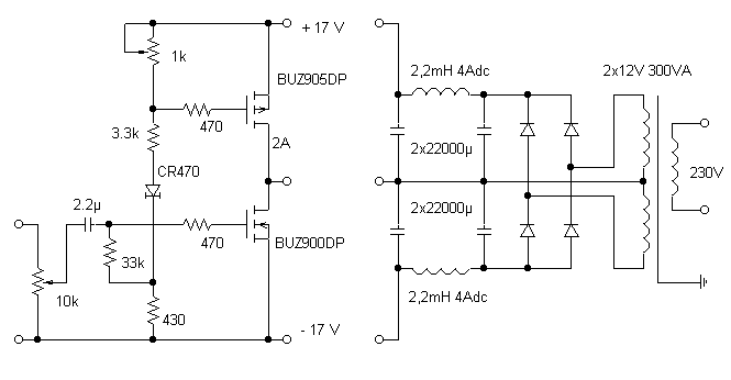

Here are some class A designs that might inspire you.
"Thierry Gibouins single ended" looks like a NFB design.
Would be interesting to know how good such a simple circuit works...:scratch:
