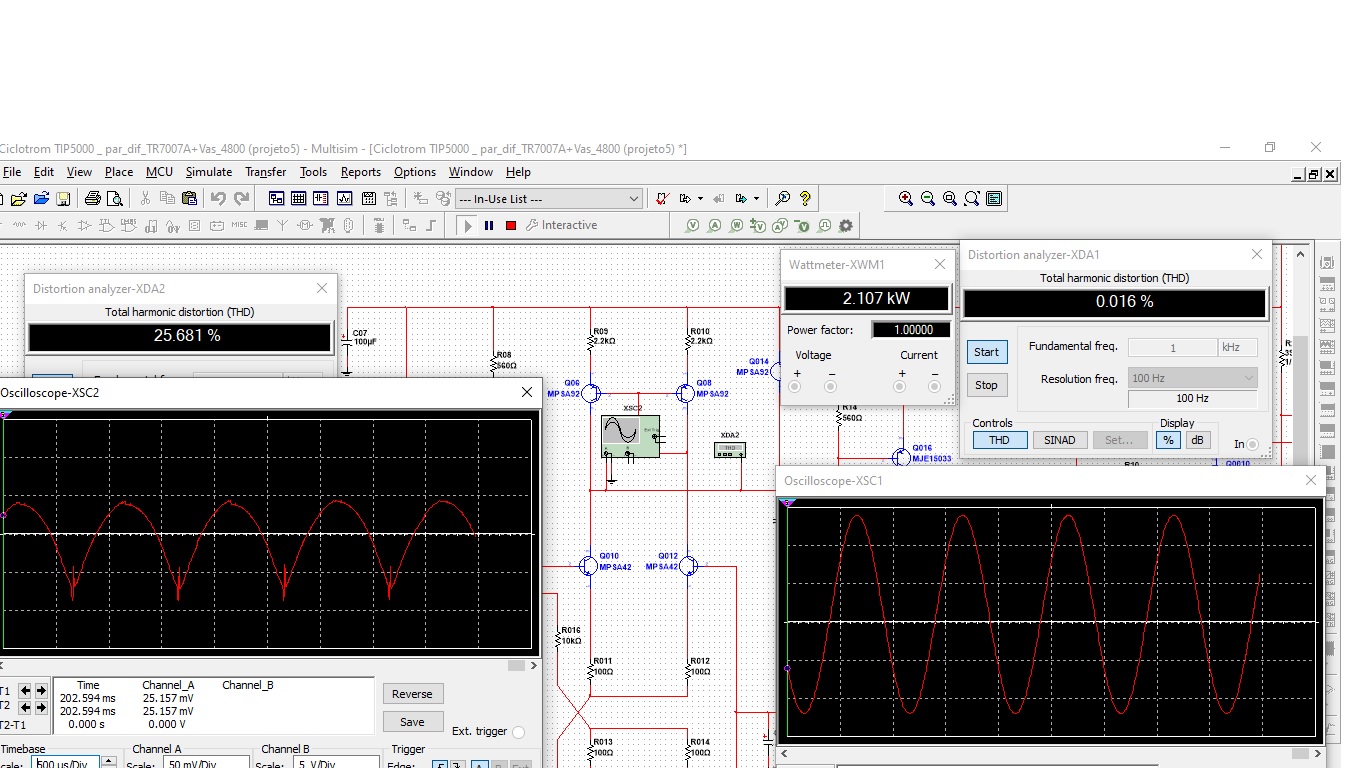

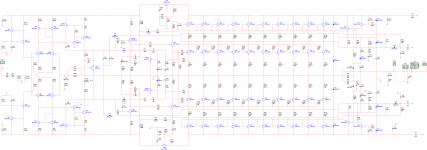

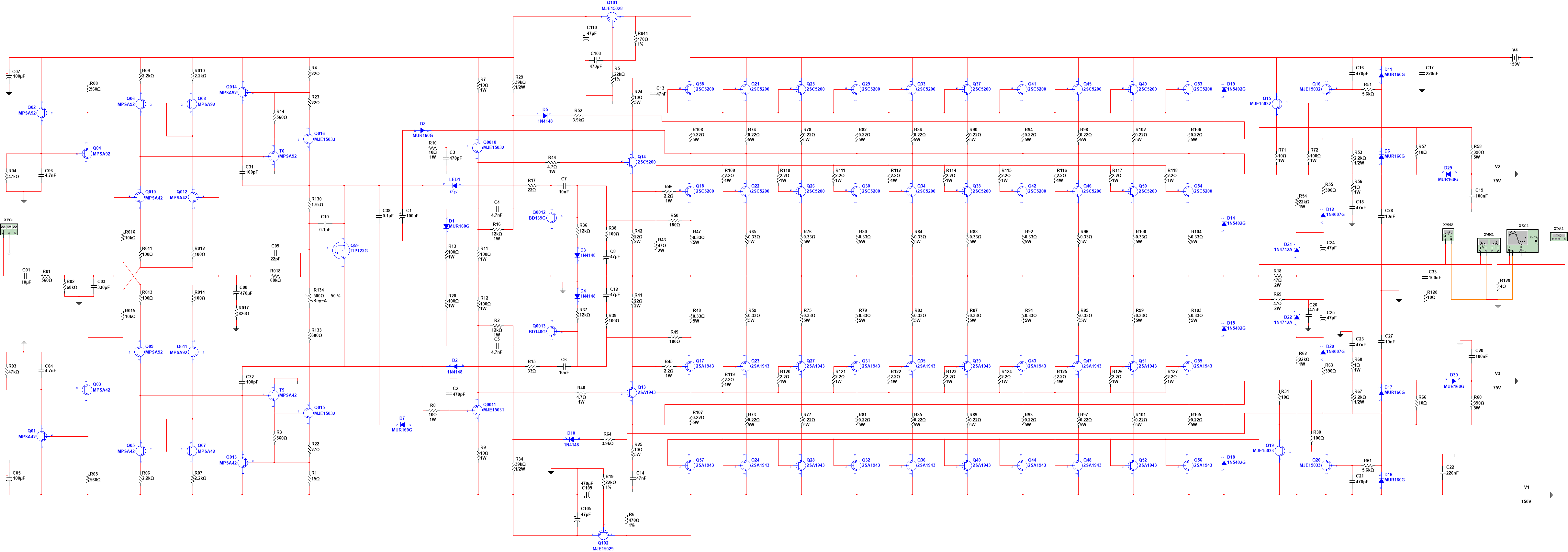

Greetings to everyone, I like to study amplifier curcuits but electronics is not my main activity. In this case I'm simulating a class H amplifier, I did simulations in Multisim and LTspice, I would like to know why the waveform in the differential pair transistor collector is deformed? Thanks in advance for the responses.

I understand, this circuit runs in multisim, but I find the deformed waves in the differential pairs collectors strange.

Have you checked the output stage isn't under-biased? That will throw all sorts of transients/oscillations around.
That “wave in the differential pair” is inside the feedback loop, after correction at the OUTPUT. Internal voltages/currents my may have all sorts of distortion.
I noticed that the wave varies according to the input signal strength and also when I changed the current source circuit of the differential pair.

Thanks JMFahey, what was strange to me was that when simulating a single differential pair amplifier, the sine signal was acceptable. So the deformed sinusoidal signal at this point is not worth worrying as the signal is ok at the output of the circuit?
The feedback tries to force the OUTPUT signal to be linear. Internal signals are what they are, in order to make that happen. If your output stage is distorting, then it’s drive signal is also distorted, in such a way as to cancel it (as much as possible, depending on the amount of available feedback).
If you simulate a differential pair on its own, connected to nothing or with a resistive load, signal will be quite clean, specially visually (you might measure a small distortion, say 1%), it is just a special case of a simple transistor gain stage.Thanks JMFahey, what was strange to me was that when simulating a single differential pair amplifier, the sine signal was acceptable
You are not using NFB and even less trying to correct "somebody else´s sins" which is what wgsky mentions.
In fact, output signal is ok because of this error correcting circuit.So the deformed sinusoidal signal at this point is not worth worrying as the signal is ok at the output of the circuit?
I understand, the information provided by you and JMFahey was very enlightening. I already follow your posts in other topics. Very grateful for solving this doubt.The feedback tries to force the OUTPUT signal to be linear. Internal signals are what they are, in order to make that happen. If your output stage is distorting, then it’s drive signal is also distorted, in such a way as to cancel it (as much as possible, depending on the amount of available feedback).
Very grateful for the help JMFahey. as I mentioned, I already follow your posts and wgsky's posts in other forum threads, they are very useful to clarify doubts. Very grateful for solving this doubt.
