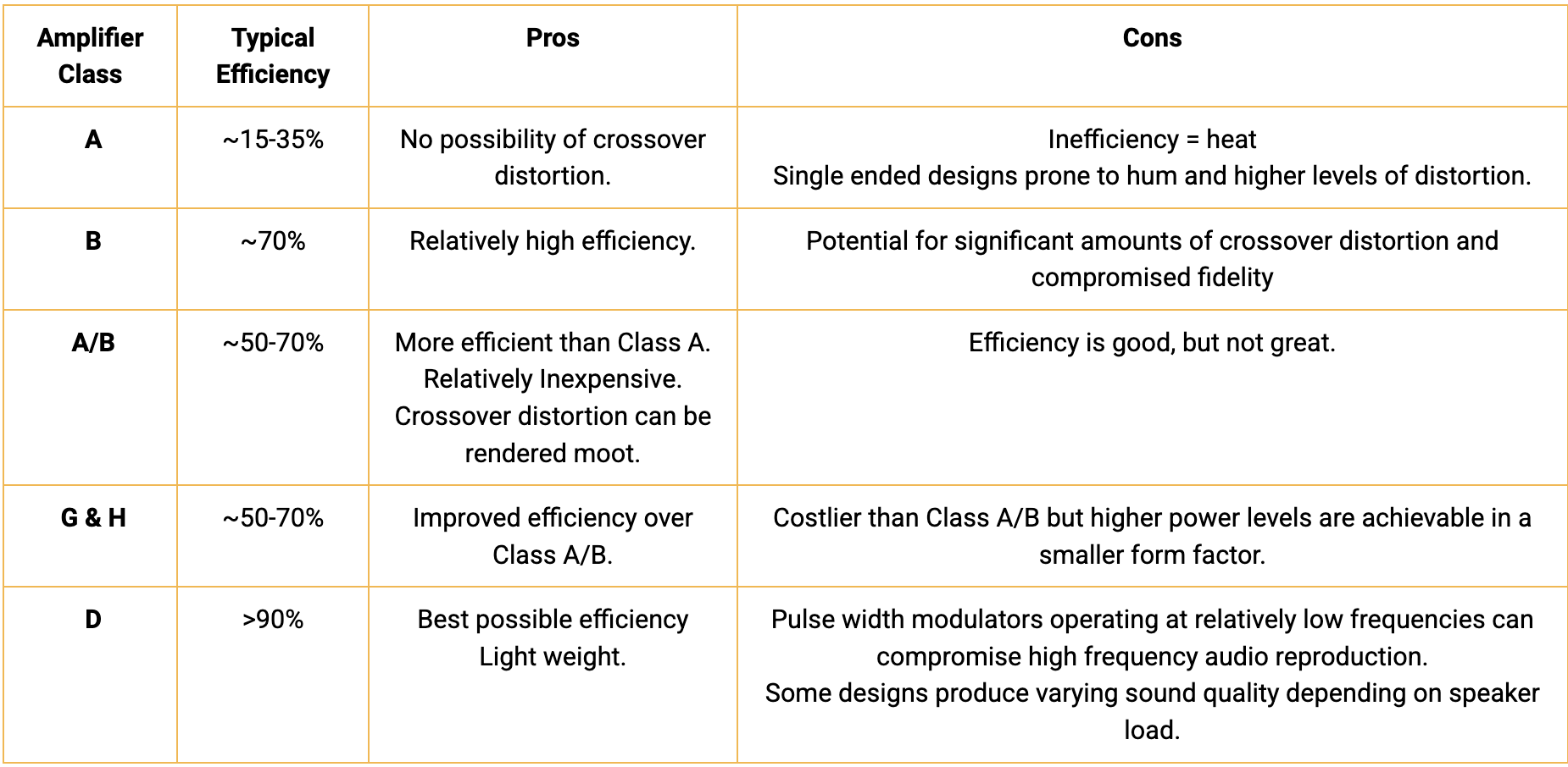

They are actually Class A/B switched rail amplifiers. Classes of amplifier describe the bias and systems in use.
The normal recognised types are Class A, A/B, B and D. Other letters are an attempt to describe different designs but are in fact a variation of either A or B with switching rails for slightly more efficiency.
This type of amplifier was widely used in the high powered PA amplifiers back in the 80s and 90s but in reality are no more efficient than Class B but expensive to produce. Some Class G or H amplifiers were only 50% efficient.
Now it is more common to use the far more efficient Class D switching amplifier.
Here is a chart of expected results;
im not sure this is accurate. the amp in question was built for only a few years before the company reverted back to a dual mono transformer traditional AB design where the power consumption goes from 270 watts to 670 watts much like a dual mono amplifier i have from 1979. the class G integrated my buddy has also has power consumption of 270 watts while being rated for the same rms power and dynamic power as the dual mono transformer designs that seemed to precede as well as succeed the class G dual rail designs.
