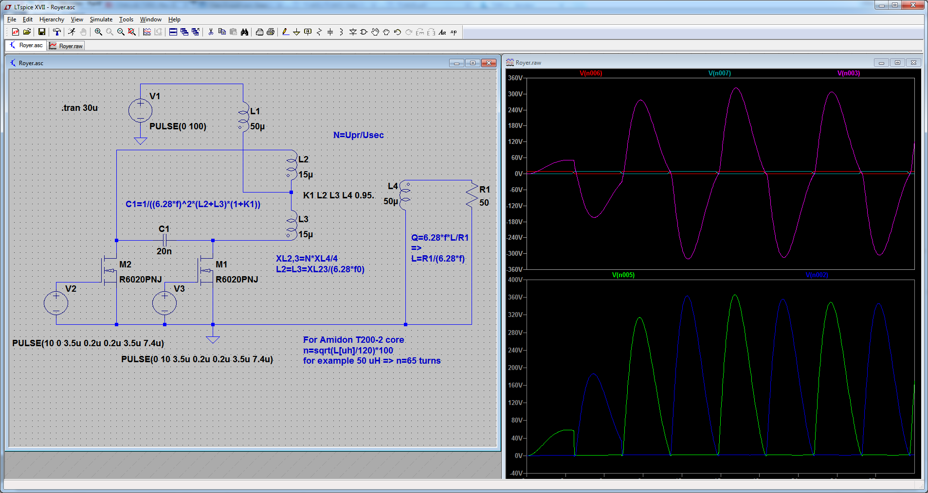

In this topology you must have negative or zero dead time. This seems OK.
But in this topology you should tune the output to resonance:
https://en.wikipedia.org/wiki/Royer_oscillator#/media/File:Royer_oscillator.gif
Capacitor must be a polipropilene type!
The second problematic thing is that you should control the inrush current, otherwise at startup voltage may go to about twice of the steady state.

Drain waveforms should be like this:
https://videoflier.com/web/jesseg/2013-08-02_17-57-04_298-resized.jpg
Dead time must be avoided in this topology.
Number 1 problem here is the lack of tuning. Number of turns and capacitance must be set first. According to the load impedance. Which is unknown...

I hope you misunderstood the first advice. Zobel network is basically not needed at all. Pure capacitance is needed strongly, and would be better to connect 1 between drains, but the connection like it is now is also usable, however not economic.
You need similar or more inductance here as in the output transformer. A good toroidal (as T200-2) is better than a ferrite rod, however it depends on number of turns and geometry (of the rod).
But the first you should do is tuning it to resonance!!!
There are more capacitance and inductance combinations can be selected for the same frequency, the difference between them is the quality factor.
For example for Q=1 you need about 50 uH on secondary. This is not the best for harmonic suppression, but still usable, and much better than the currently built.
I attached a proposed power section dimensioning.
