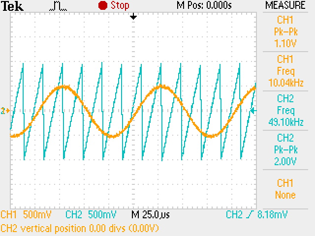

Hello everyone,
This is my first time posting on this forum. Anyway I have to design a discrete class d power amplifier in order to graduate college. I have only modeled the comparator part of the circuit. As can be seen I have built the comparator completely out of MOSFETs because I understand those transistors better than BJTs. My problem is that the input wave forms have to have a DC component in order for the comparator to work. How can I remove this DC component from the inputs and make the comparator work?

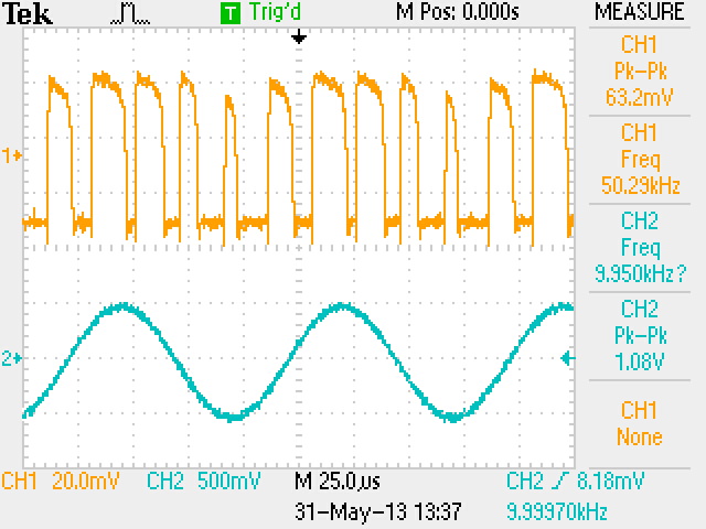

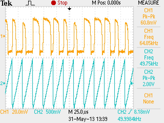

I built the comparator out of ICs (CD 4007) and have attached what I got from the oscilloscope. Again I had to give a DC component to the inputs in order for the comparator to work. I choose ICs just for the purpose of seeing if the circuit would work physically.

Nice project so many solutions so little time.
A good working and most importantly stable circuit can produce up to 200Watts RMS using a UcD modulator (see below) instead of the traditional triangle approach, which by the looks of it you using as shown in your waveforms, also note your reference triangle seems more like a (sawtooth than a triangle) this is no good in fact this looks like a "standard experimental PWM modulator" for motor control.
In the doc specification I don't see any PCB consideration by your professor which should be the first priory how does he/she expect a high speed circuit to produce good results with limited and somewhat nebulous specifications like this.
expect the circuit to produce unexpected results.( A demonstration working design can be archived on breadboard, strip-board with attention to detail especially at the switching nodes)
