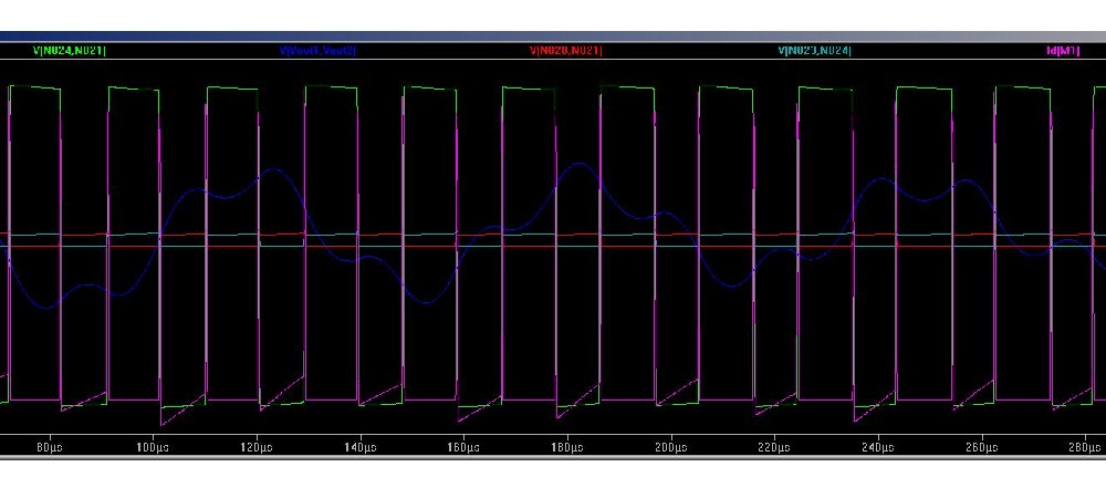

Here's a simulation of a work in progress class-d design i'm working on...
It's pretty rough at the moment & takes an age to simulate, i'm keen to drive the thing directly from rectified mains to loose the big heavy transformer (or separate psu), so i've come up wth this full-bridge design that is at least interesting!
Some of the components are driven out of spec & some are perilously close to spec (i chose components, from the libs shipped with LTspice, for their timings rather than their absolute voltage & current ratings)
here's the simulation LTspice simulation
the lack of discrete capacitors has me worried....
Be as critical as possible :hot:
cheers
Rob

@BWRX: Good point about it not being the ac voltage, doh! The circuit here is very badly labelled & specced, more a proof of concept than something to be commited to reality! I'll add the diodes, essential 😉 balancing resisitors too (& other niceties like decoupling the input, for the final design) I would like to be able to parallel the mosfets too, so that will require more balancing too, probably requiring separate drive circuits for each mosfet?

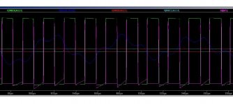

@tim_x: ltspice reckons nothing untoward at power-up assuming the power supply ramps up smoothly, the biggest worry is the cross conduction thru both mosfets at crossover, the simulation gets peaks of >200A, i hope cabling resistances & the PSU will control this. Maybe i could add some x-over delays too? The mosfets chosen are way underspecced but seemed an OK choice to get the simulation up & running.

From simulation it looked that you need to improve your gate driver. It looked that your gate driver need faster and need delay. You see that there are hundreds amps crossing yous end fets.
Your gate also already start to ON before the opposite became OFF. That is beause you don't have charging delay or your gate too slow to discharge.
Your gate driver supply for low side still 120V, wow... are you sure???
Another, you need are floating ground like felix's for your input stage, isn't?
Also looked that you have problem with communication between input stage and gate driver, level shifter problem. In my opinion it shall have difference circuit between high and low side gate driver to make good connection with input stage.

@kartino: yep i do need to look at the high current at crossover, i think a delay is the best thing here. The low-side driver was simply copied from the high-side for the sake of it! It shouldn't require a higher rail to switch, i made the high & low side drivers identical to (hopefully) extract identical performance from all the mosfets.
The level shifter is a bit simple too, but maybe it'll be OK!
The input stage requires a balanced supply too. The extra low power DC supplies will already be available from other circuitry that would be bundled inside the same case as the amp.

A few other things I had to say was I dont' think extra delay will be enough to save this. Your signals are brutally overlapping, you need tight control over the switch points to avoid that, with extra fine tuning capabilities for slew control over Vgs, where turn on needs to be about twice as slow as turn off. That's your gate resistor as one possibility. ESR and ESL wont' cut it there.
I'd urge you to do more research but also actually try out a few other known to work designs that you can build at "low power", say 50 to 100W, for a safe way to learn exactly what makes a mosfet tick.

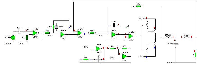

i just built a smaller version of that circuit that, It will sound very bad with a lot of distortion. You NEED to have some negative feed back for the circuit to work correctly as the op amps are not linear at that frequency. After i put feedback on my circuit it sounded good on the full audio range even with a 100KHz sampling frequency.
Here is my circuit:
i would say that i is very important to have a good amount of negitve feedback from the output back to the input. This is for two purposes,
1. The output can quite easily have a DC offset negative feedback would prevent this.
2. Op amps are not perfect at that frequency and will give a slighly distorted square wave and triangle wave. Negative feed back would reduce the affect of this on the output.
There are two ways in which you can do this, One is by taking the output after the LP filter and using an opamp to feed it back to reduce the output.
The second is to use a ramp generator before the comparitor and feed the square wave output back into that via a resistor.
or both!
also your supply rails are far two high and the chances are that the whole thing would just go bang and destroy the speakers that are attached to it.

once i solve the other problems like the incessant shootthru 😱 i'll add these to the ever growing list of things to check! I'm anticipating using very low switching frequencies & minimal distortion is not so important. DC offset is though! I'm beginning to reckon the rails are probably too high aswell, probably much better off building more than 1 lower rated amplifier rather than putting all my eggs in one basket. The speakers should be able to withstand mains directly (for a short while 😀 ) but not rectified though!

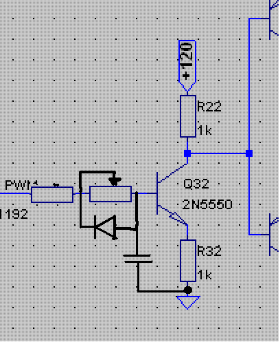

darkfenriz said:
How about such modification for adjustable dead time:
yep, i've played with adding a small dead time, i added another opamp with a similar config (your circuit saves the opamp 😉
