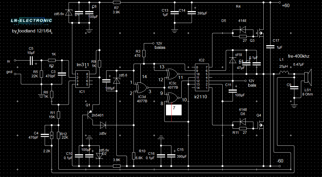

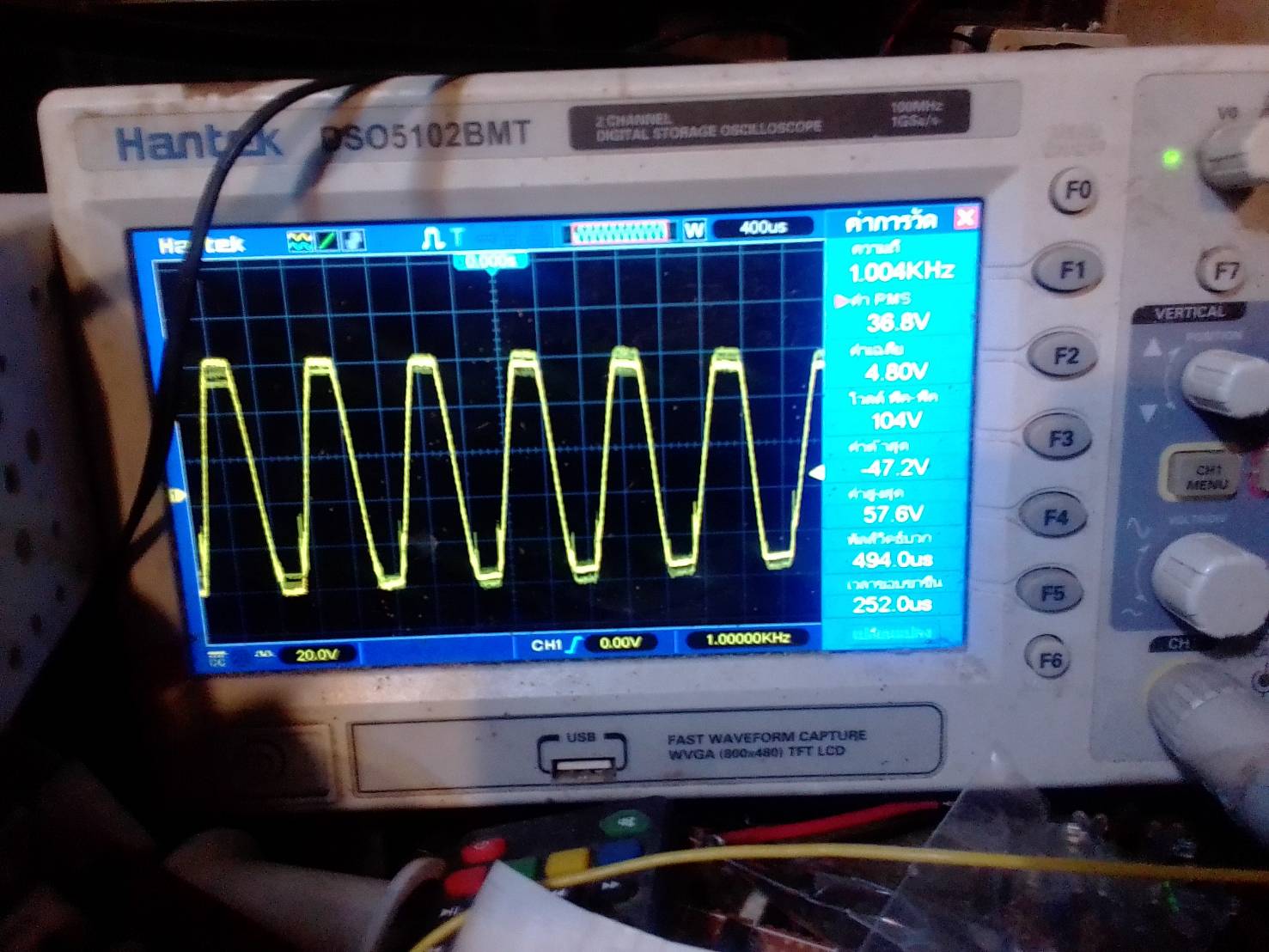

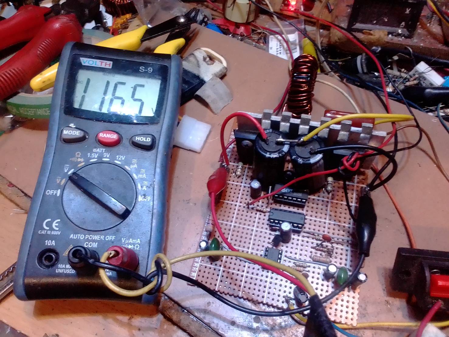

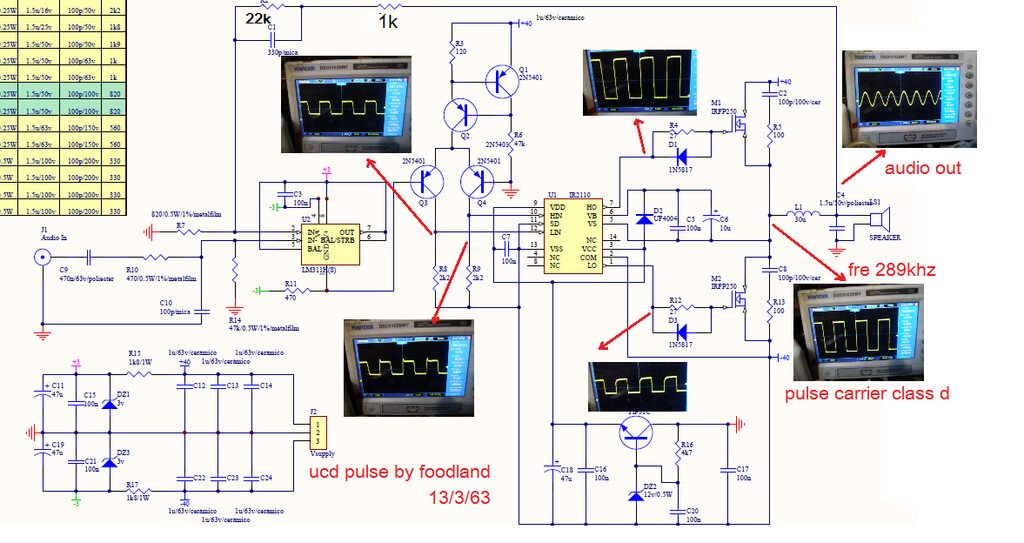

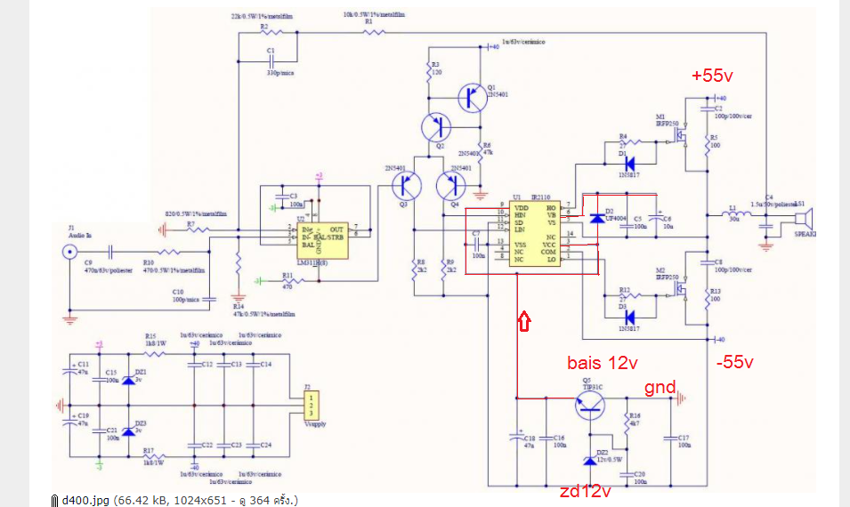

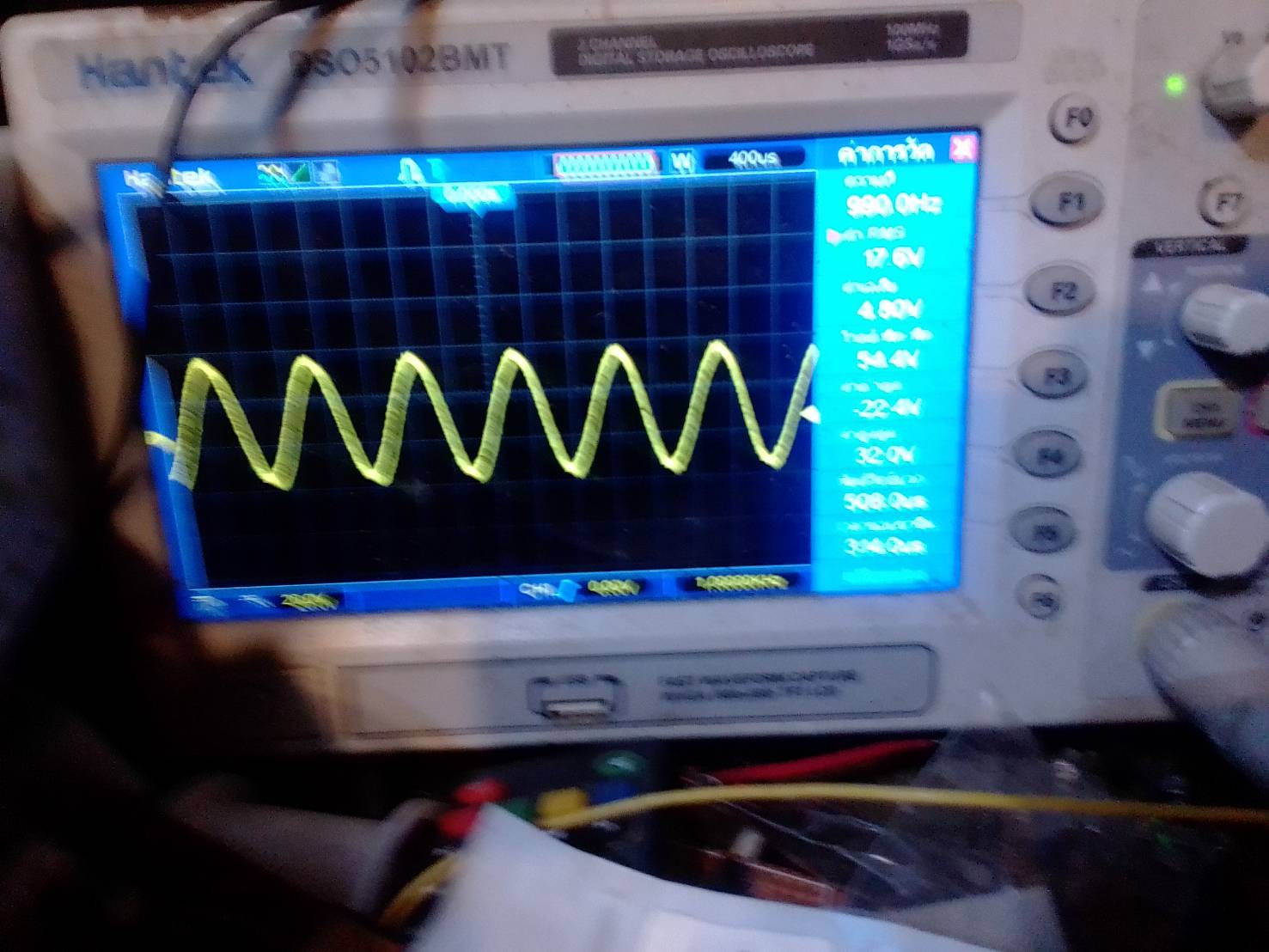

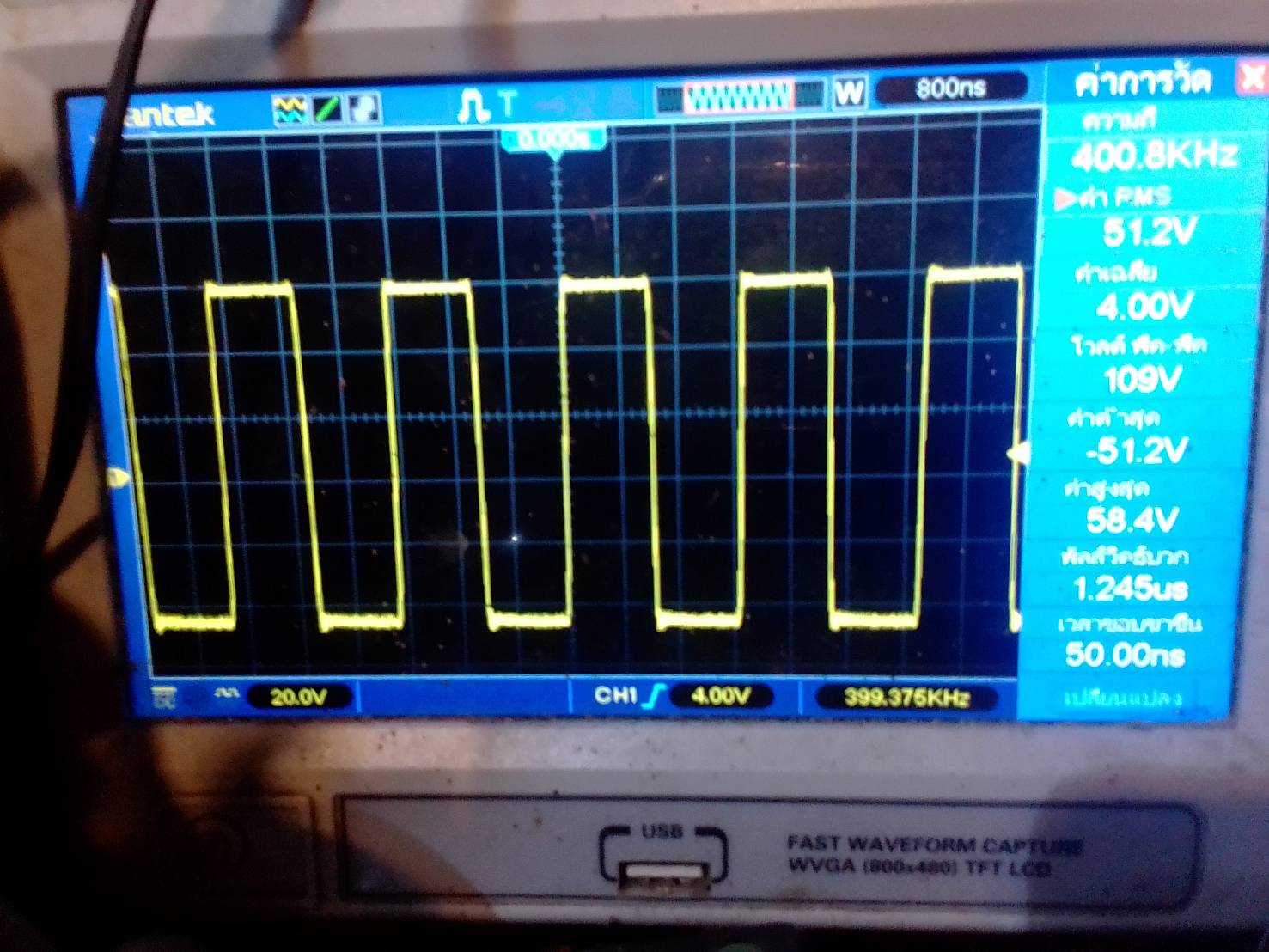

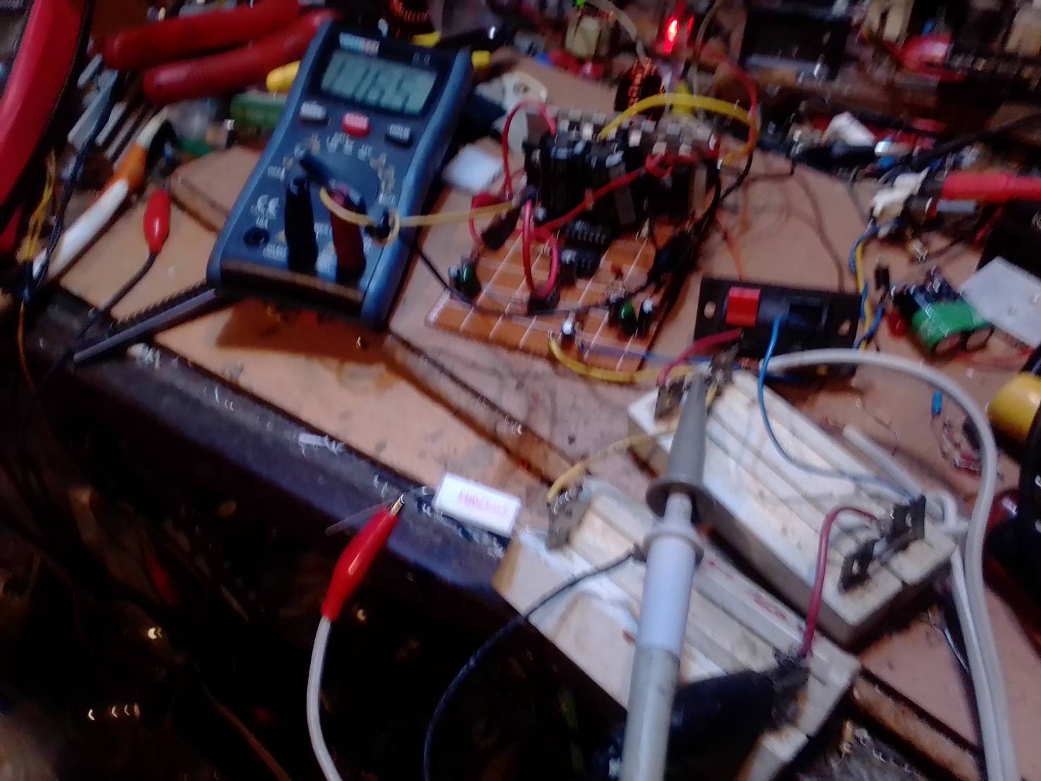

S surachit Member Joined 2012 2021-01-12 4:25 pm #1 2021-01-12 4:25 pm #1 this circuit use ex-nor cd4077 is phase inverter for low side and hide side to ir2110 Attachments d4077a.png 54.4 KB · Views: 252 15005.jpg 220 KB · Views: 213 15004.jpg 162.9 KB · Views: 182 15008.jpg 139.8 KB · Views: 194 S surachit Member Joined 2012 2021-01-13 12:58 am #2 2021-01-13 12:58 am #2 test power vcc+_55v load 4 ohm vdo class d cd4077+ir2110 fre400khz - YouTube Attachments 15022.jpg 162.1 KB · Views: 78 15021.jpg 137.9 KB · Views: 95 15019.jpg 139.9 KB · Views: 90 15018.jpg 226.3 KB · Views: 158 D Dbnn Member Joined 2013 2021-01-16 5:30 pm #3 2021-01-16 5:30 pm #3 how you get 12v bias? with external power supply? S surachit Member Joined 2012 2021-01-16 5:49 pm #4 2021-01-16 5:49 pm #4 bais 12v same anter class d it use ir2110 Attachments d ud1.png 319.2 KB · Views: 169 D Dbnn Member Joined 2013 2021-01-16 7:39 pm #5 2021-01-16 7:39 pm #5 check my project, i'm trying this schematic one week without results. Help with classD schematic S surachit Member Joined 2012 2021-01-16 10:34 pm #6 2021-01-16 10:34 pm #6 ucd 1250 this circuit is ok can you see many class d my wave side Class D Attachments 1250a.jpg 110.9 KB · Views: 193 You must log in or register to reply here. Share: Facebook X (Twitter) LinkedIn Reddit Pinterest Tumblr WhatsApp Email Link
