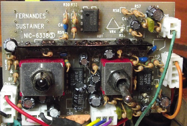

I was thinking exactly about the same. Few days ago I was fixing a guitar with Fernandes sustainer and thought "why don't they use a class-D amp (to a least minimize the size of the board)?". Have you got a schematic of any commercial sustainer? There must be something more than amp in the circuit (e.g. if you switch to harmonics mode).

What about this black module in Fernandes sustainer? Isn't it a class-D amp?

Dunno...that's the first time I've seen one! (is this the one you're fixing? What's the problem with it?)
Certainly those two black lumps look like they could be the inductors for the class d filter.
The black module looks to me like a thick film circuit with surface mounted components on it. The black lumps are not big enough for inductors but appear to be power transistors.
I cant see any inductors in the picture.

Maybe. But why? Impedance of typical singlecoils or humbuckers is typically in kOhms range, so the power consumption of "power" amp is comparable what an opamp consumes at idle. I believe you feed the signal back to the transducer which you currently don't use for picking up sound.
perhaps. But then again, class D amp - BTL variants, can get away with two smaller inductors (eg 16uh), which (certainly in lowish current capablitliies) could be surface mount low profile?
darkfenriz - remember the pickup feeds the sustainer circuit - the device on the output size is akin to a speaker (typically about 8 Ohms impedance)

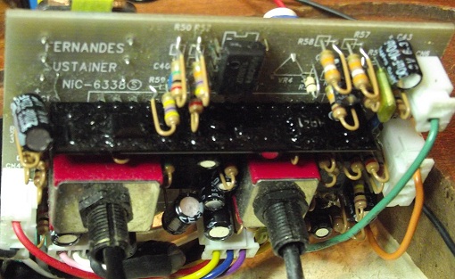

I agree. It looks like a thick film circiut with SMD components soldered on both sides. The black squares have 8 pins so they are either ICs or MOSFET transistors. There are two on the top and at least one or two on the bottom side.The black module looks to me like a thick film circuit with surface mounted components on it. The black lumps are not big enough for inductors but appear to be power transistors.
Can you see it better on this photo?
I was just adjusting the guitar and I don't have it any more. Depending on settings the current consumption is above 50 mA. I think that class D is a must in this case. And the circuit is much more complex that a simple power amp. It has various filters (used in "harmonics" mode) and a negative feedback circuit (when the signal gets higher, the gain of the amp decreases).
