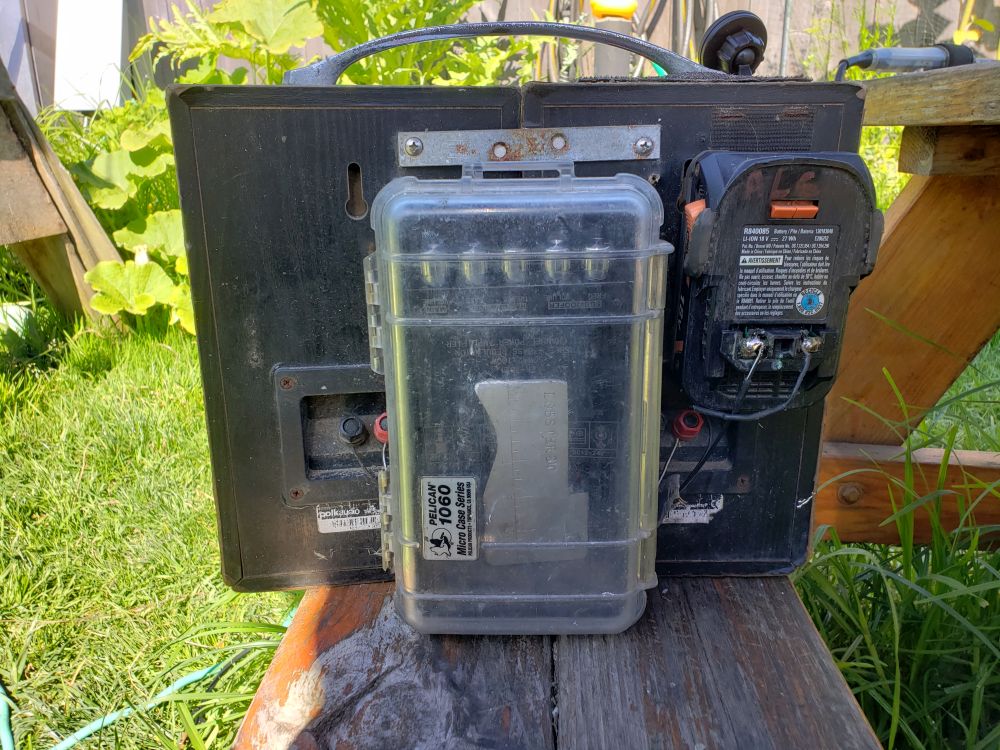

I did something similar with a Tannoy sub, using a twin chip TPA3118 amp powered by a Dewalt 18V 5AH battery. Works very well as a small party outdoor system.

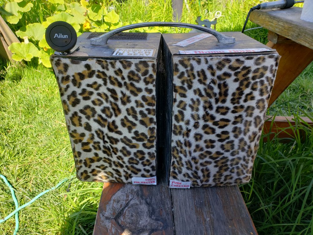

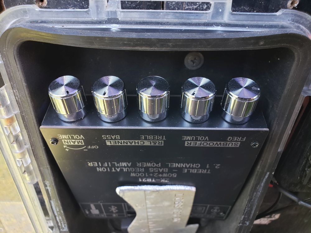

And ha on the drill battery setup! That's how I use one of mine as well, except with a Rigid drill battery. Attaching a few pics. Works beautifully.
Mine gets very beat up since it gets used mostly on my boat, where it gets covered in salt water from time to time. Still a champ after 3 or so years, though it's needed a few rebuilds over the years.
Do you get an occasional click from the battery? Mine sometimes gives a small "pop", I'm guessing something about the BMS on the drill battery. I've been meaning to try other batteries to see if it happens with them too, but ultimately it's no big deal, it's only occasional and pretty quiet.

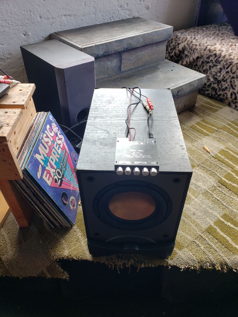

Well I got the subwoofer (Klipsch SW-8), $20 with a broken amp. Looking at the amp there were a couple of capacitors that were pretty obviously blown, but these Klipsch amps are so prone to blowing that I didn't want to bother with it.
The conversion was easy, I just opened it up and connected it's old speaker level input jacks directly to the speaker inputs. So it's just a completely passive subwoofer speaker now.
It's a bit too large for my original project (subwoofer for my yard stereo or shower) but sounds good enough that I might use it on my main stereo.
Attached is a pic of the sub with its new Class D amp, which gets a line level signal from the main stereo. I think it's an improvement over the Yamaha subwoofer shown behind it.
Incidentally lots of people use this $225 amp to power these subs when the built-in one dies. I wonder how much better it sounds.
