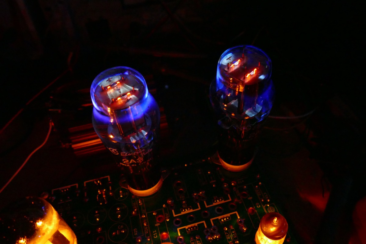

Push Pull experiments with new Chinese 2A3's got almost 30 watts on 300 volts and over 35 watts into 3300 ohms on 375 volts of B+.
My Tubelab SE and TSE-II amps all incorporate A2 capability and use the 45, 2A3 or 300B all work fine in A2. Peak grid currents in the 20 to 25 mA range were seen on Chinese 2A3's at 300 volts for over 5 watts into a 3000 ohm OPT. The grid current is lower on 375 volts for almost 6 watts at 65 mA. Yes, this is a bit over spec. Ever see a 15 year old 2A3 with (benign) blue glow on the glass?
I measured grid currents of over 500 mA on an 833A making 200 watts. I have also seen over 50 mA on 6L6GA's in AB2 at over 100 watts per pair.

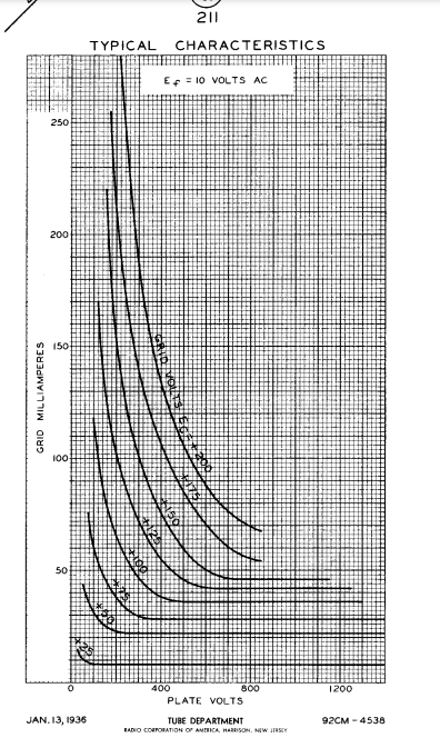

For input Z calculation, you need IV characteristic curve which includes positive grid range. There is no such curve for 300b or 2a3 etc, you can "build" or extend one yourself like described in this article and cover most of the issues you raised:
https://www.tubecad.com/2016/12/blog0365.htm
You can build A2 curve with Paint Tool and LTspice, by simply extended positive grid range on the IV curve plot.
The grid stopper if any should be carrying equal or larger current than the maximum A2 grid current as not to interfere with the operation.
The positive grid equivalent resistance tends to be asymtotic to a value similar to 1/Gm. Infinity for negative grid and a few hundred ohms for a power tube at positive grid. This is almost logical. The off-cathode space passes electrons with some resistance. It does not matter a lot if they are going past grid to plate or right to grid. Actually they go both ways but Gm rises as current increases so the negative-grid Gm is a fair guide to the higher current positive grid area.
As a rational engineer, you can see that if you must buy a beefy driver and a beefy interstage transformer, you are half-way to just using two power tubes in push-pull, which is more power at less distortion and less iron. That's why you find few A2 circuits (Bogen had a push-pull A2 triode amp) and little A2 data on the makers' sheets.
The asymptotic grid current curve shown clearly here for 211:
