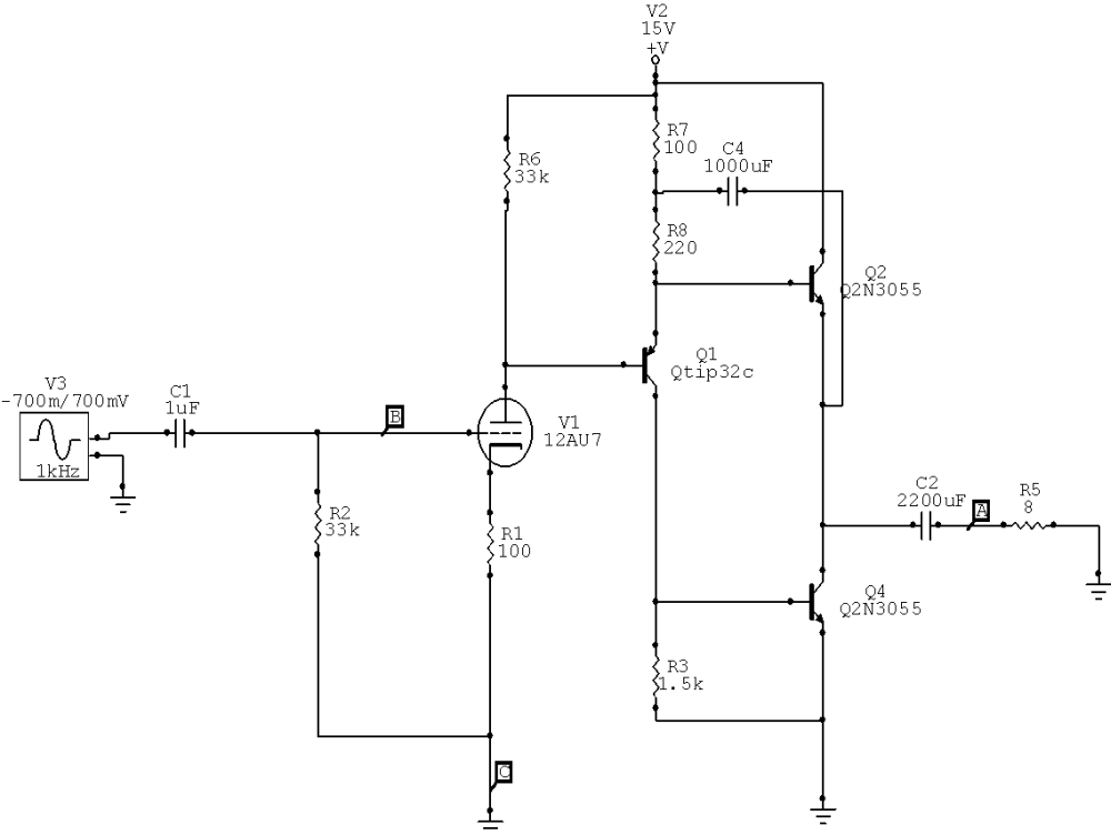

Just thought I'd throw this little circuit over here for the tube guys and gals to have a look at. It is just a work in progress and none of the values are optimum but it does work as I am listening to it now. I will later build a better unit with ccs's and higher voltage for more power but as this circuit is it puts out a very nice sounding 5 watts.

smoking-amp said:
12AU7 at 15 Volts B+ !!
What kind of distortion levels is this producing?
By the way. I don't mean this kid's project. He will defenitely learn a lot, at least he don't hesitate to think and create. Now he needs to learn how to evaluate.
I what to tell you that 12AX7 works really well at 15 Volts B+. A first, I used it in microphone amplifiers. And second, I use them in my receiver, it is miliraty beast Collins R-392 with 28V B+.
"to tell you that 12AX7 works really well at 15 Volts B+. "
Umm..., well, for microphone signal levels this could be OK since the signal voltage level is so tiny it would not see much curvature in the tube response.
The RF stage in the Collins would put 2nd harmonic and above outside the IF bandpass, so is safe.
But for an audio power amplifier, one will hear large signal tube curvature distortion up to many harmonics. Maybe could get away with this low B+ by using a more suitable low voltage tube like 6GM8 or some of the car radio tubes.

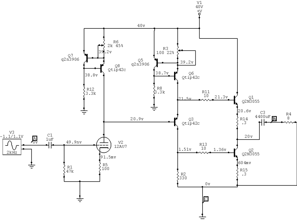

Always have to bust my chops eh tschrama lol. The circuit works just fine, as I said the first schematic was just a test build to check some theory. Since it worked out I went ahead and built a little better version. As for using the 12au7, I had one laying around collecting dust as I usually only work with bjts, a different may work considerably better. So here is the new build.

Nice touch with the current source loads. But it appears that the 12AU7 still only has 40 milliVolts of bias headroom between grid and cathode. Will be entering A2 grid current region with 1V input signal, causing significant distortion. Needs more plate current and higher grid bias. You'll need more B+ on a 12AU7 to get the plate current. Try a 6GM8 tube or maybe a high gm tube like 6DJ8.

I'd not modulate Q2's base current. Try it as a CCS.
No I do mean push pull. Me and tschrama had this discussion over in the ss forum about this output stage. The ac current supplied by both output trans. are even ie. each supplies half the ac curent that is flowing through the load.
Definitely needs a higher B+ and hence capacitor coupling to the BJT output stage. Also preferably something with a higher gain than a TIPxx in the driver/phase splitter stage.
As it is now, there is a considerable lack of output swing (hence far lower efficiency than possible), and it is also highly non-symetric. It would be prudent to check clipping conditions, and judgeing from the symbols used in the schematic, not to trust the default model for the AU7 triode in Circuitmaker because it has paifully little in common with the real world AU7 especially at low currents. Perhaps a voltage doubler for the tube B+ (would give you 80V) and use a 6DJ8, maybe even both sections in parallel (each section has it's own cathode resistor).
As for 'it works'... I am sure sound comes out if you connect a speaker, but the devil is in all those details...
