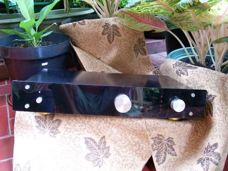

WALTER BURKHARD said:but the sound is good ..and a better one..
NE 5534 and BD139 and BD140
regards Walter

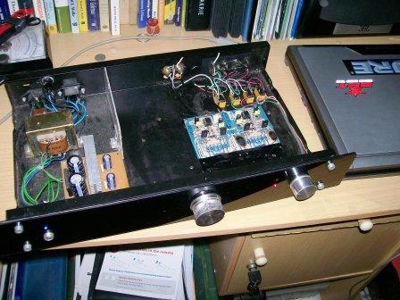

Hi Walter
Don't you find 4,7 K is to low for a preamp input ?
The NE5534 (my favorite op amp ) seems overcompensated , he needs 22 pF for unity gain and you use 87 pF for a gain of 2 , any special reason?
Regards

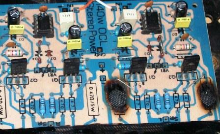

Nordic said:Wat is up with those burned resitor spots?
Ha ha ha... yups! resistor burn , thats pcb is ex my old power amplifier kit.
That I call recycling... 😉
