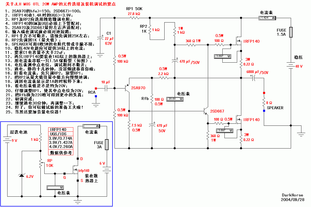

Class A power follower
This is only concept.
Any coments please...

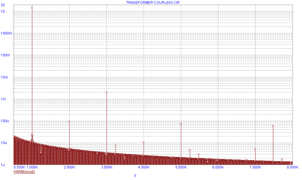

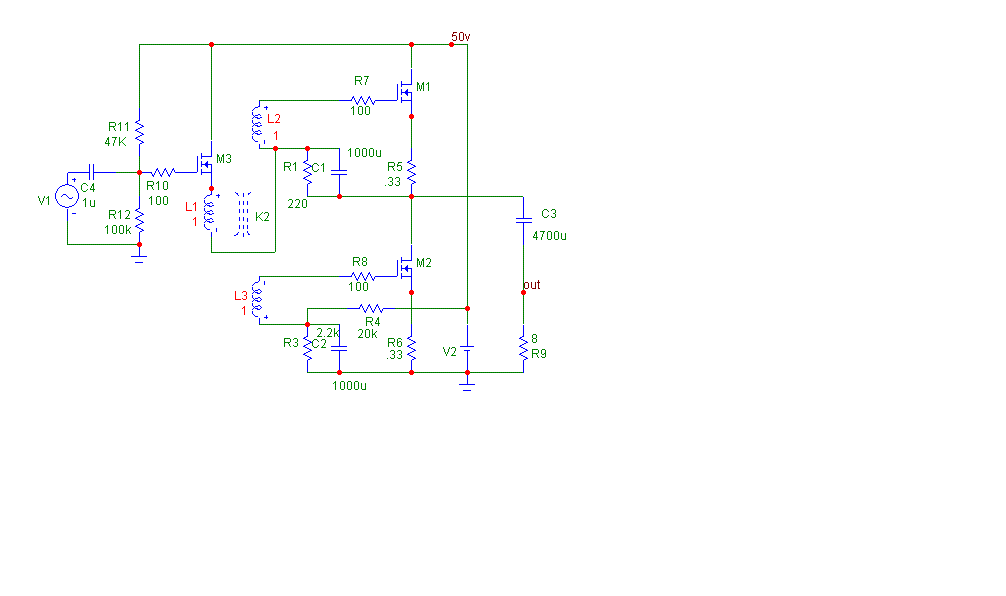

Right, but with class A (idle current 1.3A) much better results.
What spectrum of simulation?.. 🙂
With this bias it will be class A, up to 25W/8ohms.

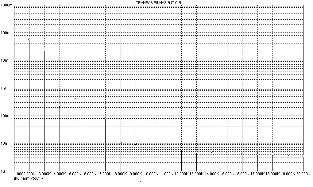

The spectrum means low distortion, but the large 5th harmonic looks strange for me...

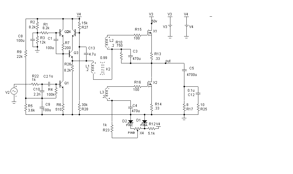

Feedback can helps to reduce the distortion, but with interstage transformer You can't use more the 14-16dB without instability
