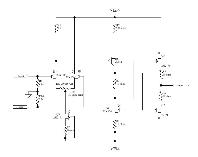

jackorlando11 said:
Hi!!
Can anybody help me to make Class A Op-amps??
Choose an op amp that you like, tie a resistor of suitable value from the op to the neg rail so one of the op transistors stays turned on. Hey Presto...😉
If that is not what you meant there are some descrete designs around that I may be able to find.
Cheers
mike
here is another one
here it is
