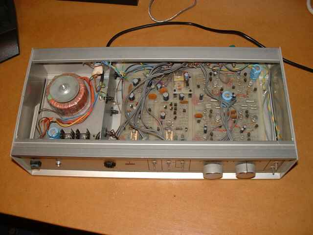

Just browsing and I thought I recognised your board layout - I built one of these (must have been around '83) together with a discrete preamplifier from ETI (remember Electronics Today International? :RIP: ).
Just dug it out of the garage - as you can see - poor quality components used throughout!
I remember etching the board in my parent's back garden and stripping the paint off the door with Ferric Chloride (an accident).
I have long since lost the articles, and the peak-level indicator board appears to be missing, but I wonder if it still works...
NB. The piggy-back board is just a delay relay for the preamp (RH side of board) and I think the paint spots on the transistors was for gain matching.
