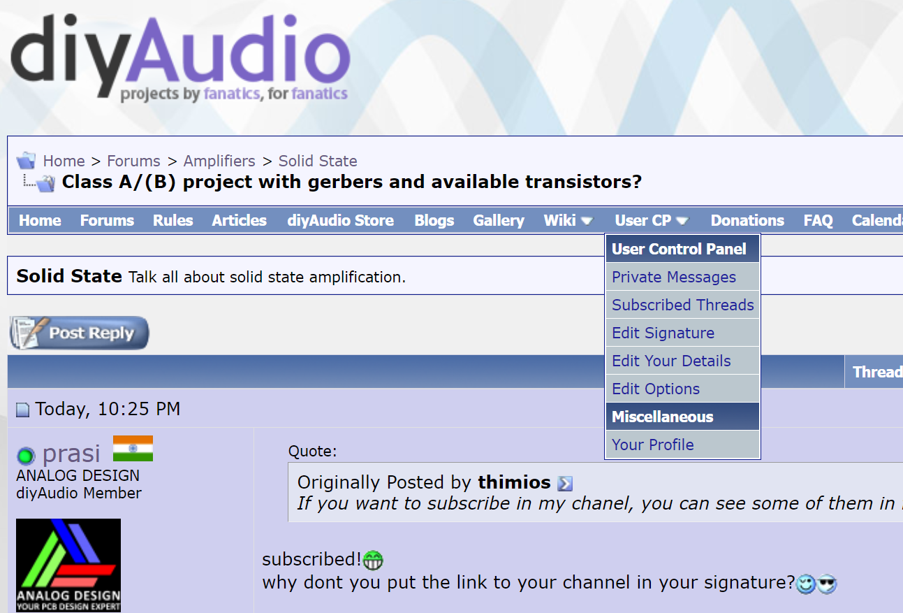

why dont you put the link to your channel in your signature?😉😎
go to user CP---Edit Signature---then paste link of your channel and click save signature
