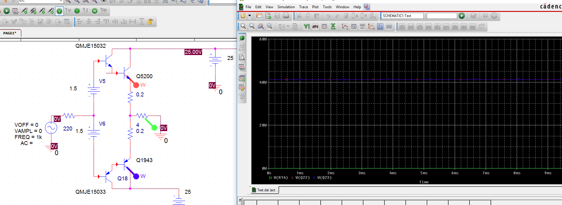

This is what happens - I had this simulation setup (just the output stage) on hand:
Current Flows no signal:

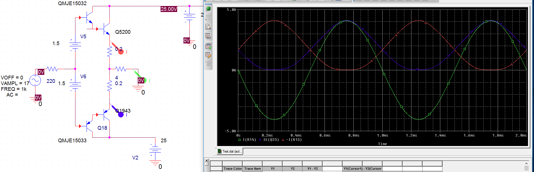

Current flows with signal (almost maximum power):

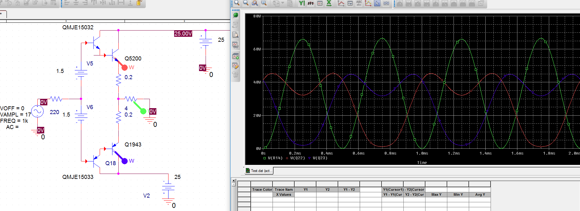

Instantaneous Power Dissipation with signal:

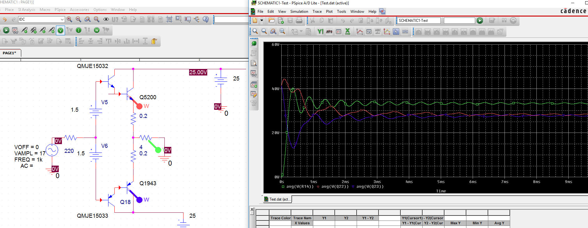

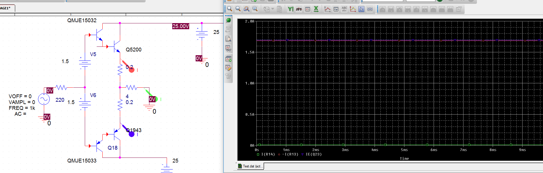

Average Power Dissipation no signal (Red and Blue are on top of each other since they are exact the same)
Average Power Dissipation with signal:
