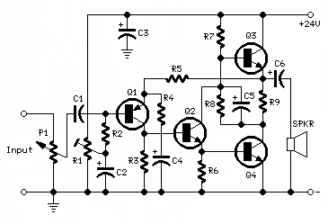

This is Flavio Dellpiane's version of Class A - 7W. Every sensible ear longs for one to build. I prefer this one to Jean Hiraga's or Nelson Pass' as it is less frightening for a first timer! No FET, no toroid or big capacitor, at-least what it promises. I just need the best pcb layout for the schematic. I'm not very good at simulation software, though I tried few times.

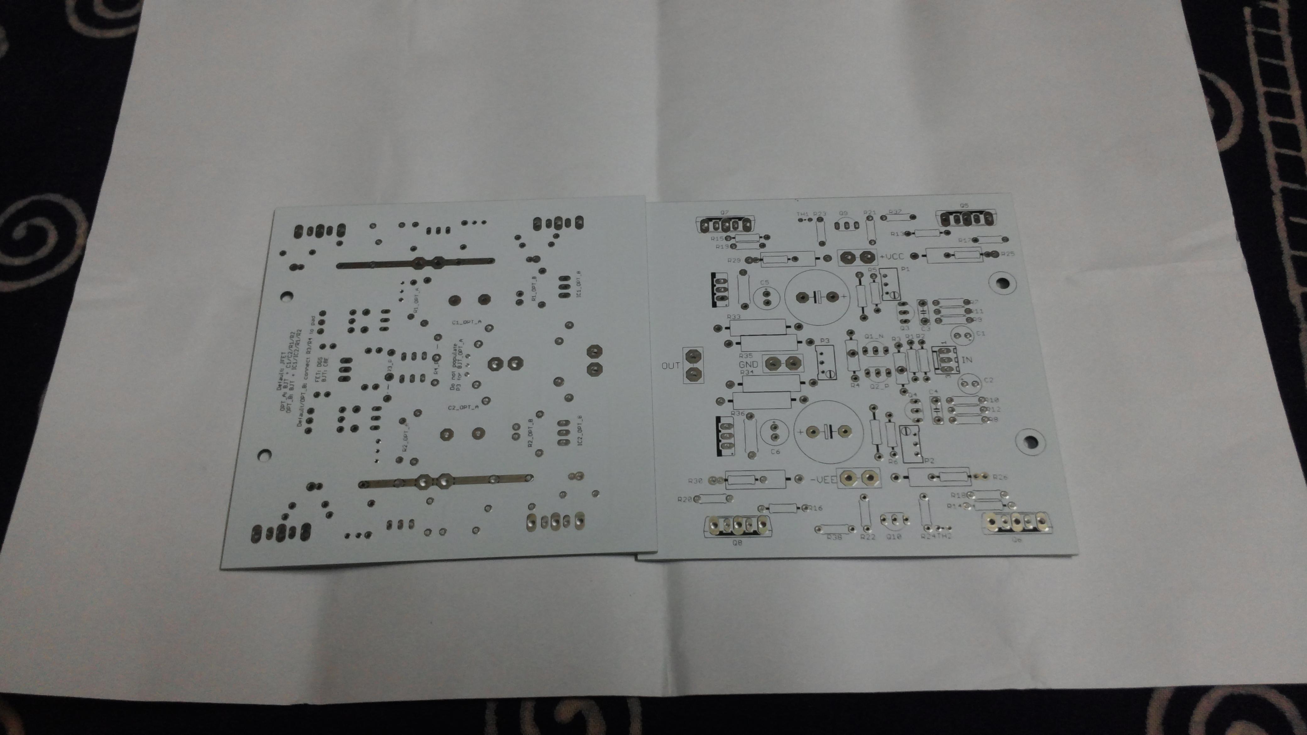

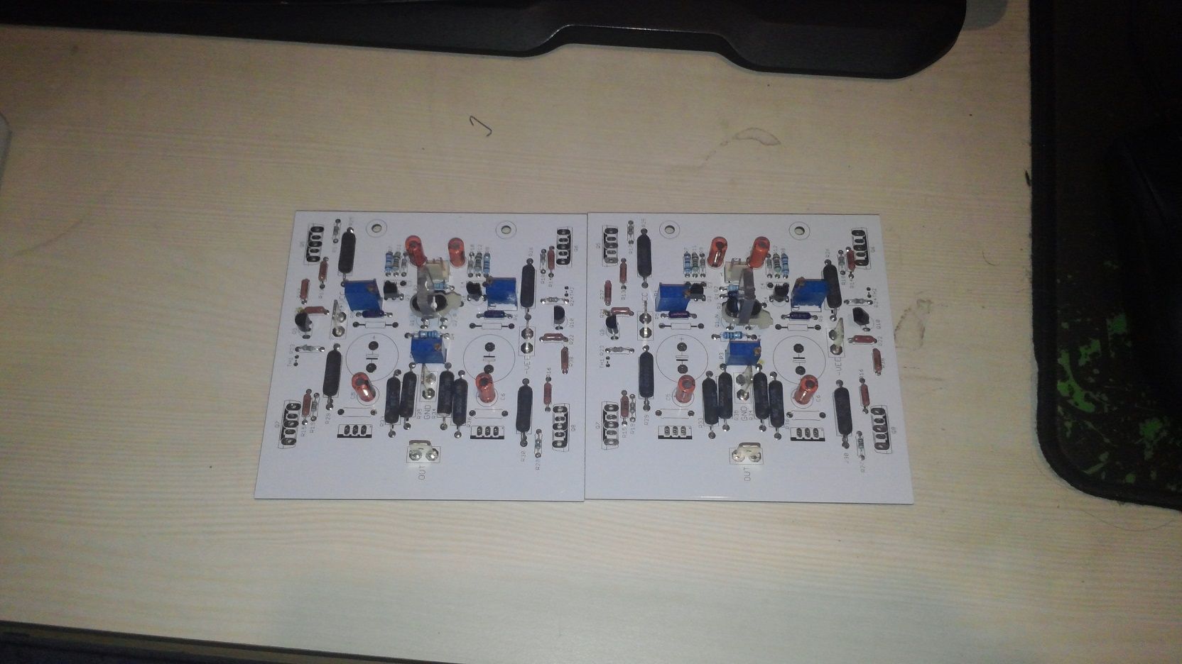

I had created a PCB that accepts both the JFETs as per the original F5 design, as well as the variation by juma - and work with the very oddly shaped heatsinks usually available in India. Fans are required on some sinks - but it was possible to achieve very low costs for building an amp based on this kind of circuit. Some pictures are attached, this build used the input JFET but you can see the RC combination for the bipolar input. Sorry I have none left. But it is possible to wire these up P2P, they are that simple.

You could build this on veroboard the way the circuit is laid out. It is just a matter of correctly spacing the pins in the matrix to take the components - and use hook up wire to join these as required.
This was the method used by Linsley-Hood for his simple Class A amplifier - the power transistors were mounted on heat sinks with flying leads to the board. This amplifier is similarly simple.
If you want a pcb you could follow this general practice by drawing the layout on graph paper and glue (diluted PVA) to the top side of a blank board - then drill out the holes and draw the connecting traces on the copper side.
It helps to have a scrap piece of wood behind the copper when drilling - to make it easier to smooth the hole edges on that side.
The earth connection should be at the input end of the board. The other thing to do is to have the output leads/terminals and power transformer as far away from the input leads as possible.

Thanks Michael, you understood me truly. Placing the power transistors to sinks and the earthing are the issues for many.
