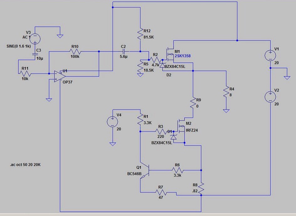

here is the diagram. a single ended mosfet driven by a constant current generator.
Rg not 4.7k but 220ohms.
And mosfet all irfp240.

For the resistor what value do you think i CAN place. Prevention is better than cure. 😡
cards have already been tested. and they work very well. no oscillations. I think.

One thing … While having the MOSFETs connected the way you do is fine, my own inclination would be to experiment with having the output tied back to the inverting input, to close the gain loop from source all the way to the tail. yes, as others will likely chime in quickly, there "are things to consider". But just about all distortion that might come from the MOSFET tail could be reduced to negligible levels.
also - It is kind of late in the design to suggest this, but having the big capacitors above your heat sinks is asking to cook them big-time. Not wise. It would be better to position them just the opposite. Move the heat sink to the top, and put the electrolytics on the bottom.
8 Watts only? I think you're going to get closer to 20 watts.

certainly. but I wanted to make it simple amp. Open loop and single end mos.
The power is limited by the constant current generator. It delivers about 1.5A (Max). So with a 8ohms speakers, the amp Will be around 8W only rms. 😕
The mosfets dissipates 30W in static. the temperature should not rise too. I think. I also install computer ventilators to cool it. 😕
What do you think?

For the power supply two pi filter. 4700uF->0.22ohms->22000uF->2.2mH->22000uF.
Looks like a good approach to me - the real test will be if you can hear hum or not as SE no-feedback design is the most susceptible. I don't have enough experience to say if you have enough power filters there. The choke is a good idea, will help cut out higher frequency noise (at least up to the limit where the self-winding capacitance of the choke shunts the inductor).
Your heatsinks are identical to Fischer SK56.
300mm X 40mm, 30 ribs.
If their height is as what they appear to be on the pictures, you'll have a temperature problem, and you'll cook the electrolytic cans.
Are you planning to use them with the airconditioning on ?
Thanks all.
My heat sinks are 300mm x 70mm 0.5°/W. For the test. Finally i Will use a 300mm x 150mm. But do you think That 30W dissipate is critical?
For the fans i Will use this. Supply by 8V. It Will be silent.
