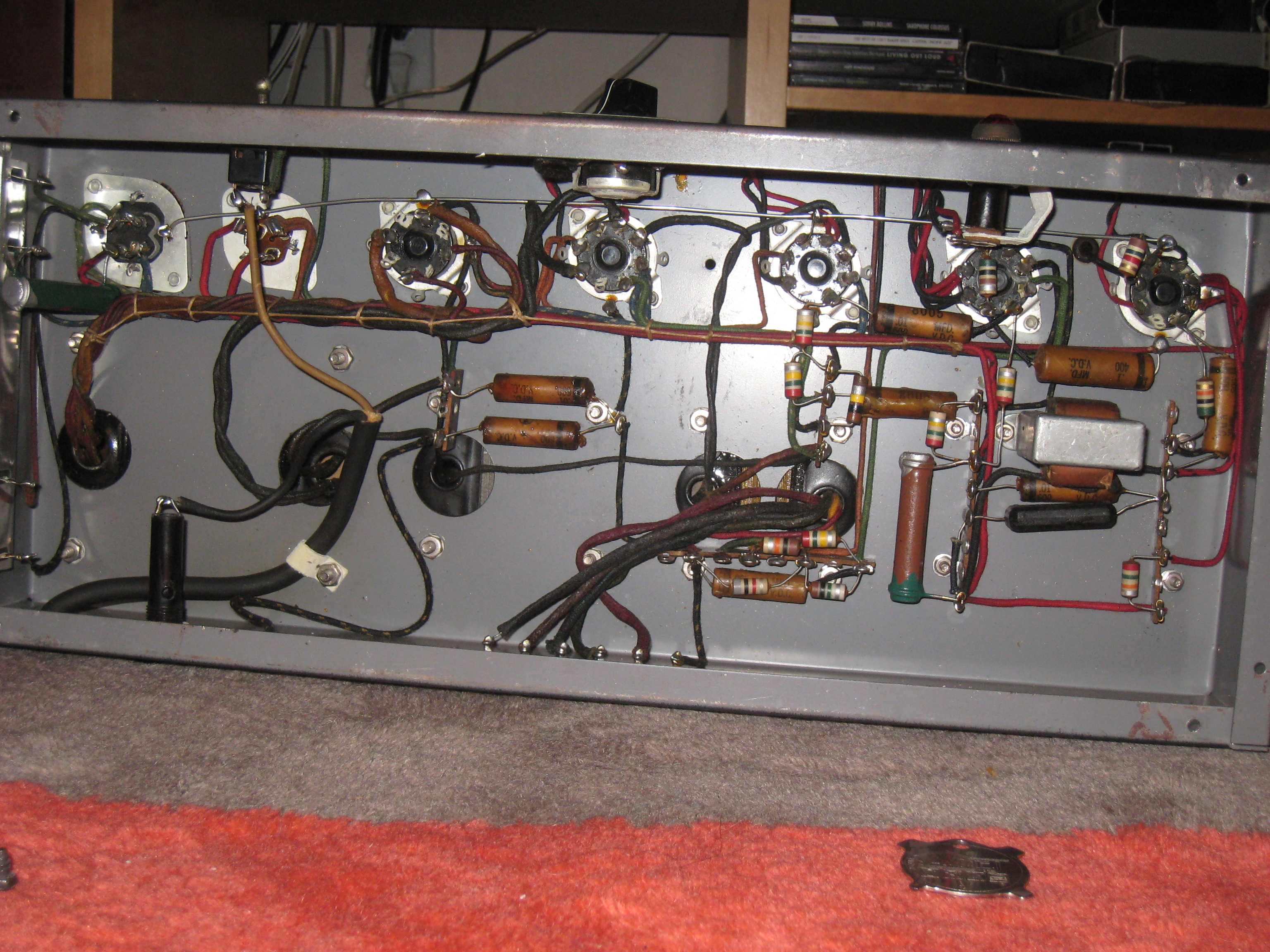

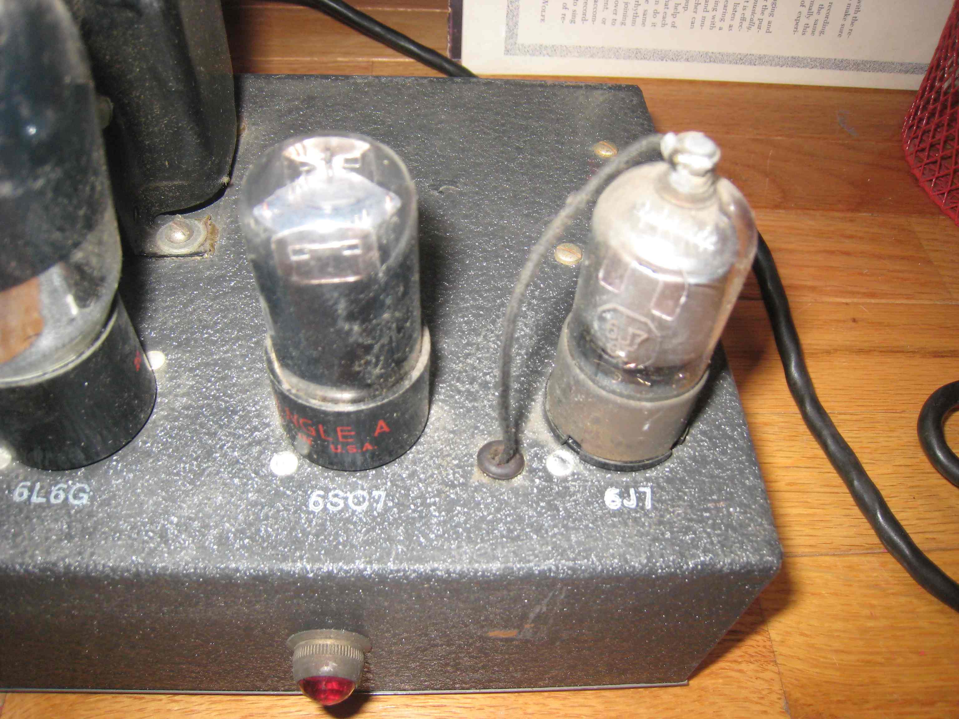

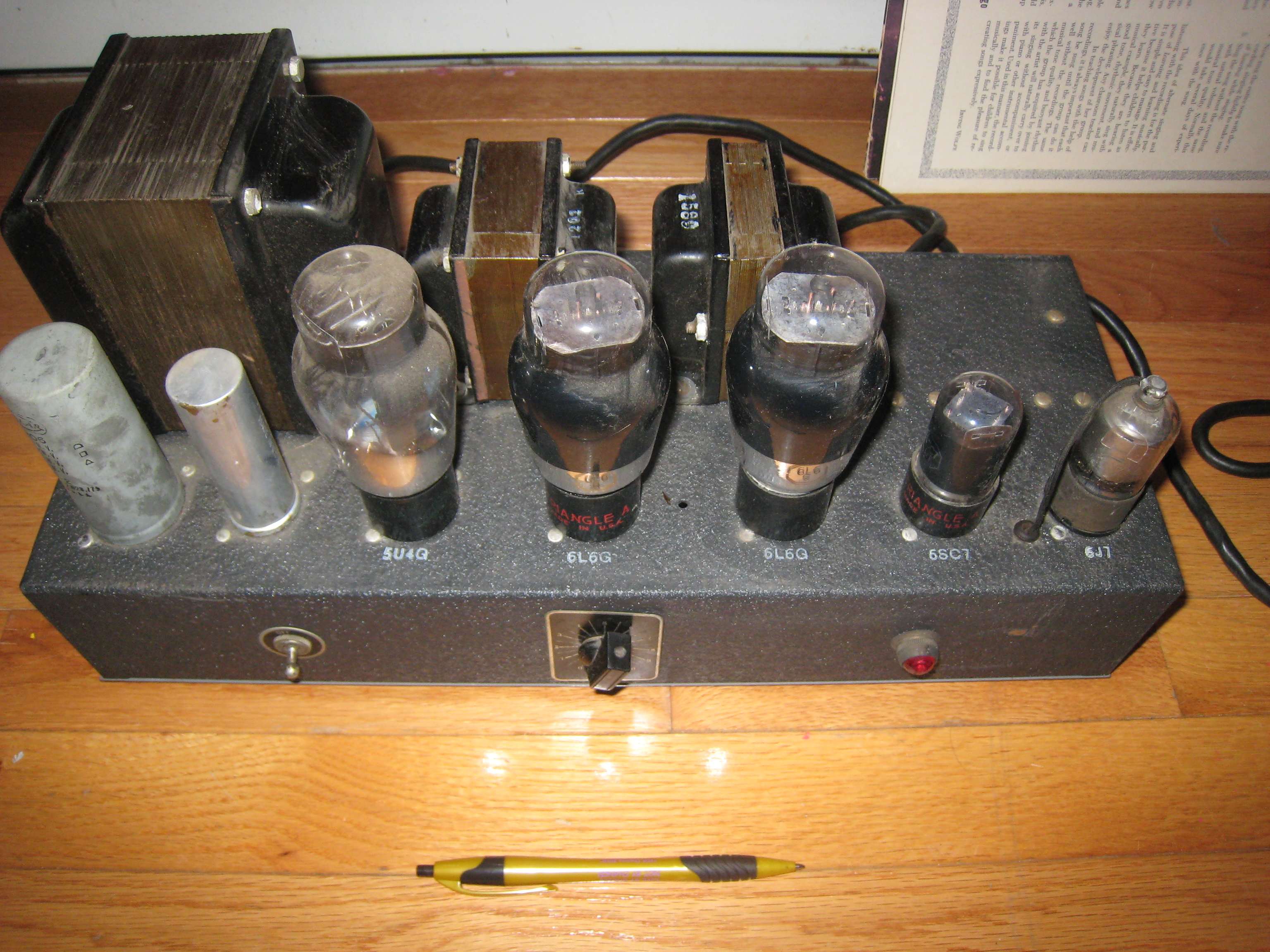

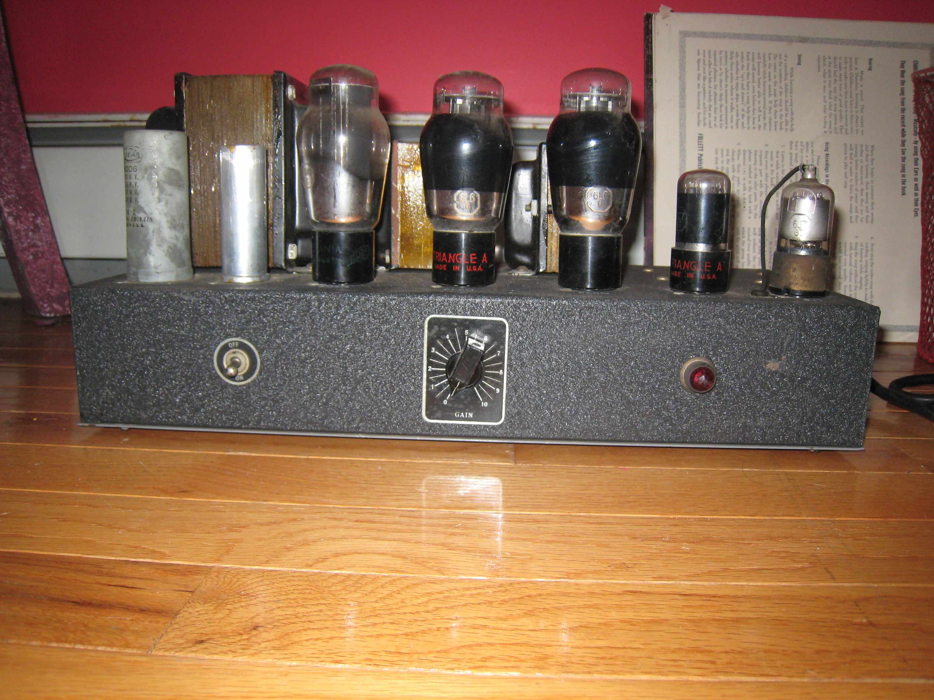

I came across this amp when my school was clearing a science lab. The badge says Clarion Sound System-Transformer Corporation of America. Bottom plate has schematic and adds that this is a Oscillator Amplifier. It uses two 6L6G tubes and a single 5U4Q other tubes are: 6SC7 & 6J7. The power transformer is huge as are the other two.Taps are : G-0-2-4-8-16 Oddly, I don't know where the inputs are! As you may have gathered, I know very little about these things other than how to operate my Dynaco St-70. If anyone has any information on this amp I would greatly appreciate any info. Photos to follow.

Being an "Oscillator-Amplifier", I would think it has no inputs. Oscillator-Amplifier implies an (audio) signal source (the oscillator) driving a power amplifier. I see no frequency control, so it may be fixed frequency.

I'm sure you could do some simple modifications to it to use it as a conventional power amp. You would just need to disable the oscillator portion (which may be as simple as pulling a tube) and then figure out where to inject the audio input signal. The top cap on that one tube (6J7 ? I can't see the pics as I type this) would be a good place to start (as an input point).

The picture of the bottom of the amp shows a very clean and easy to work on design. It also reveals several wax coated paper caps and very old resistors. These and the electrolytics all need to be replaced before any long term reliability could be assured. As suggested minor rewiring of the input section and removal of the oscillator inductance would make this into an amplifier. Is the output transformer capable of handling the frequencies needed for subwoofer duty? That would depend on the power level.

The 6L6G's are somewhat a collectors item although I have found them in the dollar bins at hamfests occasionally. This is not a problem because you can substitute any of the later 6L6 variants including the 6L6GC which is still being made. Ditto the 5U4G. The other two are often found in old radios and still available from anyone who sells tubes for this market.
