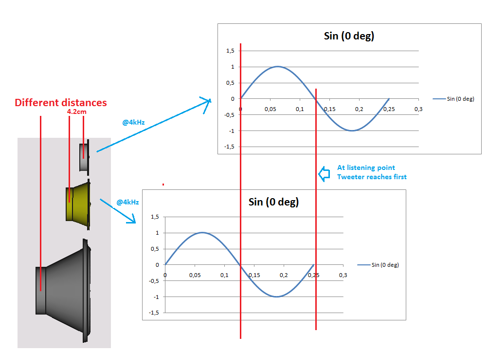

When using multiple drivers which will overlap (in the crossover frequency region anyway), their mutual phase difference comes at play. That is because two equal signals (assuming steady state sinusoidal signals) with the same phase add up to +6dB, listening axis. Two equal signals with phase shift of 180 degrees cancel each other out completely. And any situation inbetween gives a sum somewhere in between. So the phase differences of drivers are important in the crossover regions, just to get the levels right. And that is why you need accurate phase and delay figures of the individual drivers.I do not understand how phase is addressed in the design process.
Hi!Your explanation has certainly helped but it is increasingly apparent to me that the fundamental problem here is that I do not understand how phase is addressed in the design process.
(I learnt this from markbakk, allenb and other members who greatly helped me sometime ago)
Maybe some images and examples can help to explain.
Suppose Freq=4kHz. One period (360deg) has 1/4000 = 0.00025 or 0.25ms
Sound speed in air = 343m/s or 34.3cm/ms.
The length of one period (360deg) of 4kHz sinewave = 0.25*34.3 = 8.575cm
Half of the period (180deg) = 8.57/2 = 4.28cm
If one speaker is positioned 4.28cm backwards, for example, at 4kHz, they will be perfectly "acoustically" out of phase (180deg) even if electrically in phase.
At the crossover region, both speakers will produce the same frequency, but one sinewave reaches the listening point delayed thus causing the phase misaligment.
In any other distance difference, acoustic phase will be anything from 0 to 360 for the same frequency.
And if you change the frequency, the phases will be different for the same distance.
It's a mess - that's the reason why you need timed references in your measurements when you build your crossover, cause you will sum all speaker frequency and phase response. With timed measurements, all the phase effects will be considered (polarity, crossover, geometry and speaker acoustic phase changes) since REW detects the exact distances (in milimeters) that each speaker is from the microphone and register them in the .frd files.
In XSim or other crossover simulator, it will read those distances and take them in consideration.

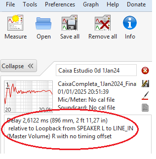

REW measurement distance

Correct. All that phase information should be captured in the measurement for the software to use, and that is why the absolute timing between the raw drivers needs to be captured when you do your measurements. The software will still produce a result if that timing information is missing, but without it, it cannot be known if the simulation is reflecting reality.I was expecting a processs step where i was required to somehow look at phase curves and align them but are you saying that the design software includes both electrical and acoustic phase information in determing the summed frequency plot so that essentially all I have to do is optimise this combined SPL curve?
Yes, the crossover simulators, such as XSim, do everything for you, as long as you provide the .frd (frequency response + phase) file with timed measurements and the impedance file (.zma) of the speakers in the enclosure where they will be installed.I was expecting a processs step where i was required to somehow look at phase curves and align them but are you saying that the design software includes both electrical and acoustic phase information in determing the summed frequency plot so that essentially all I have to do is optimise this combined SPL curve?
All your job is to work on the crossover elements, the filters, by defining the inductors, resistors and capacitors to feed each speaker.
The design tool will add everything together and present the final sum for you.
