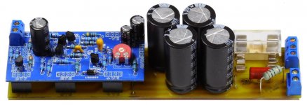

I've decided to build the Citation Mosfet 12. I just have a couple of component related questions
I can get IRFP264's at a really good price so I'm thinking of going with these.
In terms of drivers:
I can get 2n5401 for the P types. I can get 2SA970's but they cost around 30x more than the 5401's ( is it worth the extra cost? )
I want to use 2n5550 for the N types since these are complementary to the 5401. I can't get a complementary 2sc for the 970's!
Any Thoughts?
I designed my own set of boards to fit a standard 40mm square aluminium tubing that is readily available here. The other great thing about this is I can press fit a small 40mm DC fan for forced cooling!
Mark

You could have a problem using the IRFP264. The IRF100 has a Ciss ( this is the input capacitence ) of 600pf but your IRFP264 has a Ciss of 5400pf ! That is likely to high for that front end to drive.
Ok I'll use IRFP240's these seem to have the lowest input capacitance of what I can find here.
thanks for pointing that out 🙂

So here it is, my completed MF12 board. Designed with separate output and removable driver PCB Complete with PSU smoothing caps 4 x 3300ufd 50v. Size is 160mm long by 38mm wide. PCB mounts to the the heatsink through the mosfets which are soldered to the underside of the output board.
I designed this to fit a common 40mm square aluminium tube extrusion that we get here. will attach more pics of a completed amp module with heatsink when ready
Thanks to all for your guidance
