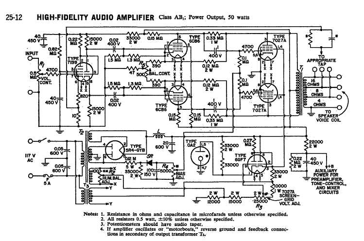

RCA 50W amp
Perhaps this is the one you mean ? Uses 6CB6 and 7027s. Found in the RCA RC-23 and RC-25 tumbe manuals, possibly others as well
There is also a 50W RCA designed amp which uses 6CB6's in a sim config which is a more foregiving design and sounds better musically using 7025's. I'll have to track it down.
Are 7027's interchaneable with 6l6's? They are in the same family I thought, but could not recall the differences between them.
