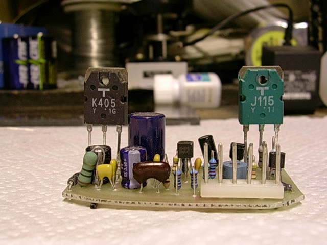

Pass citation article.
Pete, that is indeed the article I built it from. I had a Citation 12 for all of my high school and college years. I sold it when I started building more serious amps.
The board in the picture is out of my car amplifier. Has put up with years of use without any problems. The final page of that article is the schematic. Regards, Steve
