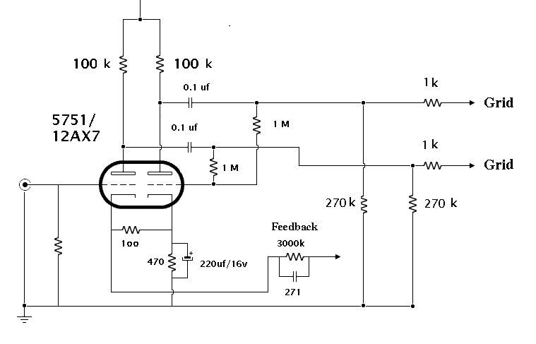

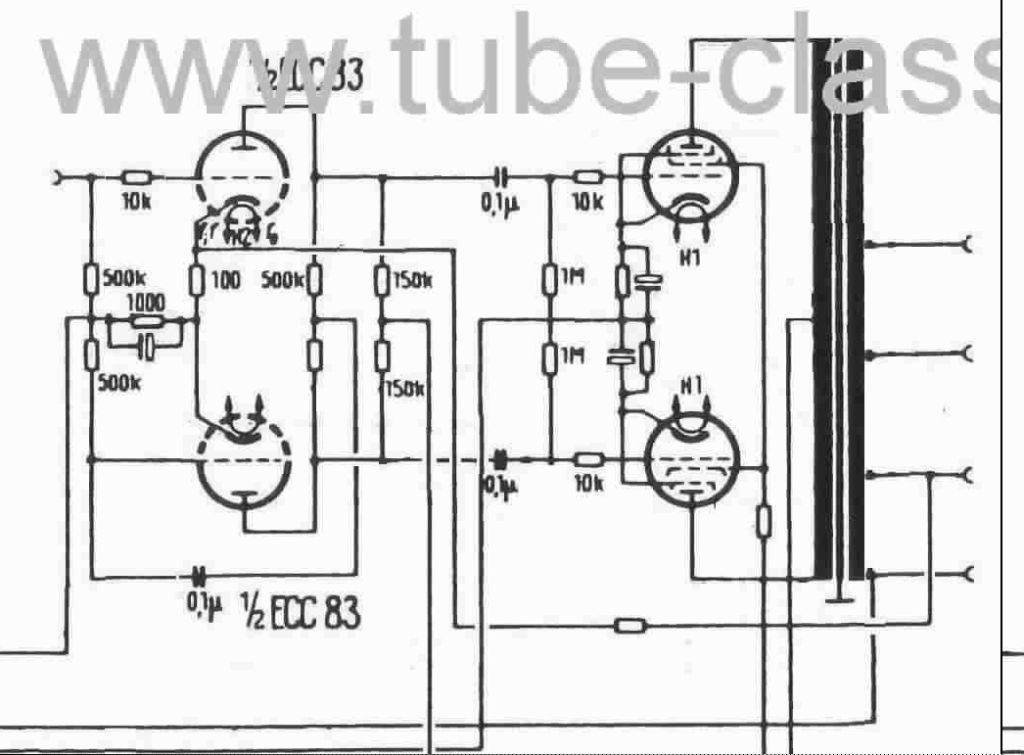

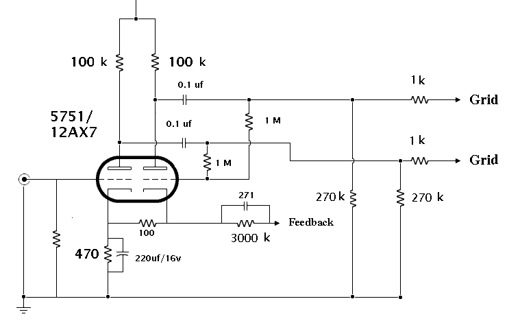

Well, first of all, better is a subjective word. HollowState posted a circuit I have tried too. Sounds good, "better" than the Magnavox but the "best" one is this self balancing floating paraphase:
The Valve Wizard
Leben uses that one too. Smart guys, the Japanese have good ears:
6moons audio reviews: Leben CS-300X

I'm not certainly an expert, but I think the Magnavox style is opposite to modern audiophile design goals. It is a hign gain, narrow open loop passband, that is flattened and extended by using heavy global NFB.
So, pure pentode mode and high gain input stage, big RA resistors and low current operating point.
It is correct?
It is correct?
PD and not to forget , a single Rk resistor shared by the four output tubes
It's not an LTP with a current source so I guess you're right. 🙂
Gain is low, I think it was 6 or 9. Anyway the high gain tube and GNFB is pretty common in pentode PP amps.

One more thing, I would suggest trying a 5K pot in place of the feedback resistor. You need to know how much feedback is needed. Some speakers need more, others less. You'll learn a lot, fun to make your tube amp sound like transistors just by rotating a knob.
Bypass cap depends of your OTs so the value is orientative.
Yeah, I was trying with the pot trick before, to determine the amount of FB in a self splitting experimental circuit. You definitely notice when the amount of FB become too much, it start to scream like a banshee 🙂
