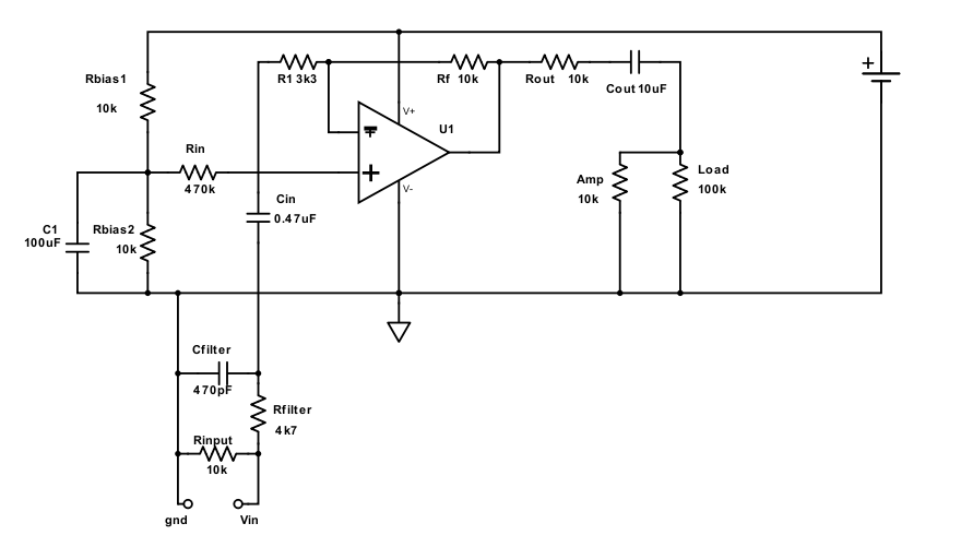

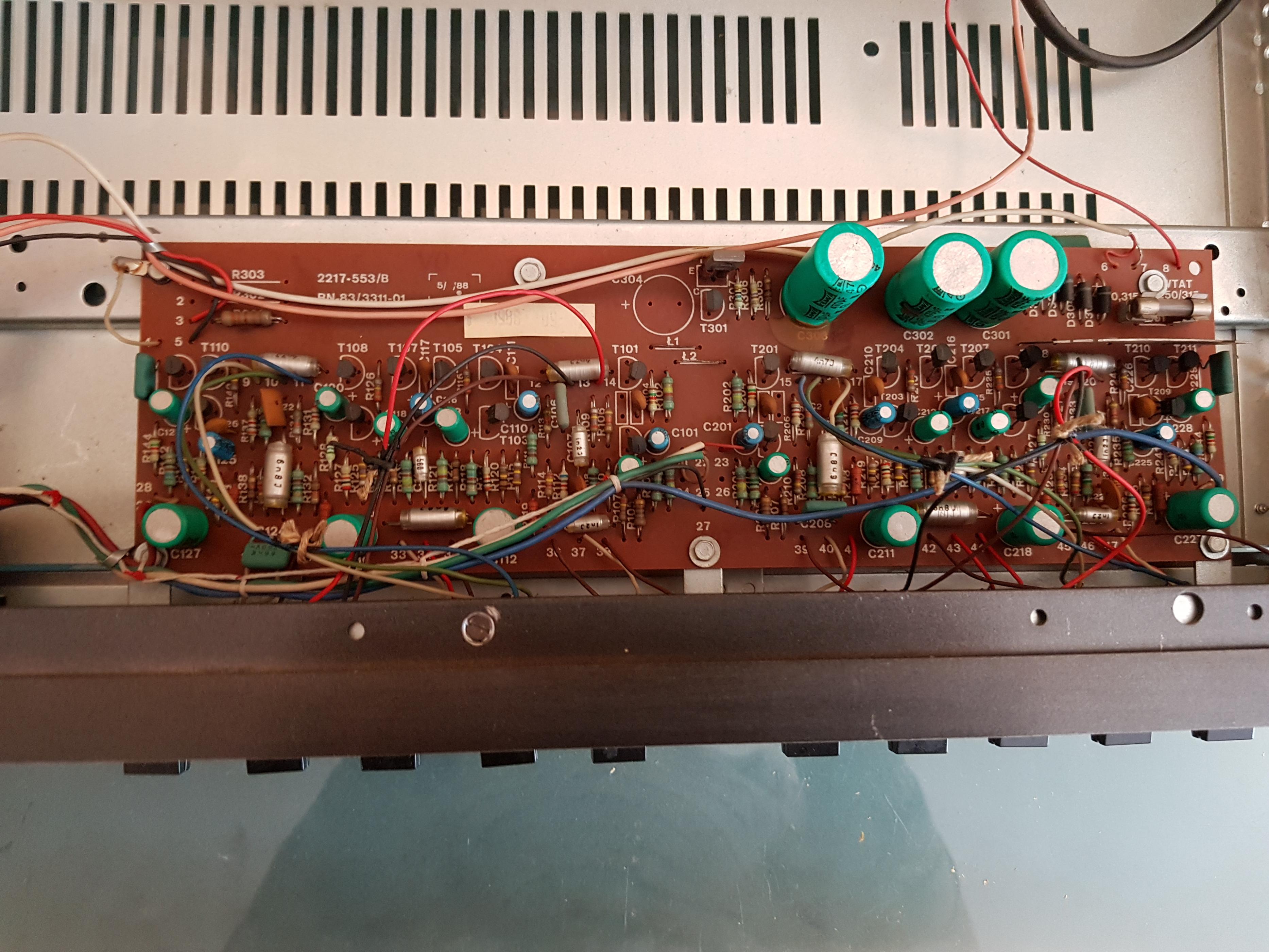

Hello,
I have late 80s equalizer that I would like to modify for PA use.
I would like to keep the slider pots, they are in good condition, not scratchy or anythink and build new circuitboard for it.
It`s a 2(stereo) x 5band, pots are 100kOhm.
And I would also need gain control to match consumer line level to professional line level.
I already made circuit for gain control, lpf and bass boost thanks to user "Mooly", this is the design of gain control:
However I will try to modify it for +-15v supply, so it will be able to get higher gain before clipping.
I`m thinking of putting this circuit before the EQ.
Than I also have low pass filter and bass boost that I will use in this project (for now I think that this will not be EQed or that I will add a switch to select if it will be or not).
So the main thing is that I would need circuit for 5band EQ, with 100k pots, supplied by +-15v or only +15v. I would like to made it with NE5532 or TL072 IC`s (I like what I hear with my NE5532 and TL072 based circuits and I can get them near me).
Faceplate have labeled frequencies 60hz, 250hz, 1khm, 4khz and 16khz, but it`s not important to me to keep this settings...

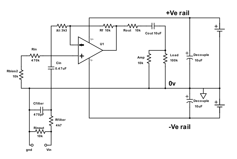

As an afterthought I would rather use +-12v, because I will sometimes power the system by generator, and I would like to add voltage regulators and insure stable +-12v.
Remove Rbias1. Link out Rbias 2. Remove the -ve pin of the IC and connect it to new -ve rail. Ov point is now the link at Rbias2 point. Decouple the +ve pin to 0v and decouple the -ve pin to 0v using 10uF electrolytics. This will work with + - 9v upwards to the maximum voltage of the IC.
Thank you for this
I draw schematic, if you could take a look at it and let me know if I did it as you meant.
Specificly I`m unsure about Rbias2 resistor.
Here is the original that I had to redraw:
Here is the modified version:
Thank you for you help.

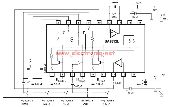

Hi, if it's for PA use I wouldn't be too concerned about Hi-Fi quality, any of those will do the job. Equalisers
Hello,Hi, if it's for PA use I wouldn't be too concerned about Hi-Fi quality, any of those will do the job. Equalisers
I would like it to sound as best as I can... I would use LA3600, but i don`t know, when I saw it`s application list, first thing that I tought of is that useless EQs in walkmans...
Do you have any experience with LA3600? I realy don`t know what to expect from it? I`m satisfied with NE5532 and TL072 quality...
I have a realy nice, dynamic sounding amp, later I will buy some good speakers, so I don`t want so sacrifice quality
Thank you for the link.
I will try to find some information, it`s Yugoslavian RIZ from 1988, there is one transistor for one pot... Will dig a little and let you know...What is the equaliser you have, do you have a schematic or know it's topology?

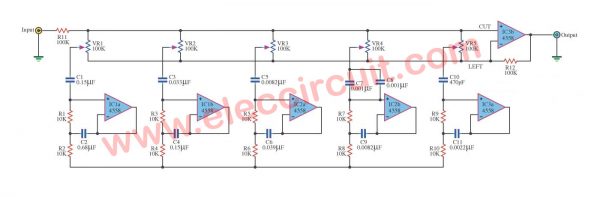

There is no schematic on the internet. The best I can do is the picture of it's pcb.
I readed thru the website and I can`t find out if this is good or bad. The EQ doesn`t sound right to me... Maybee replacing capacitors and resistors would sort this out. But there are alot them, so I think that building something new with 2 ICs or more would be better option, plus it would make the circuit more compact.It probably uses gyrators built around emitter followers. Example in section 7 Gyrator Filters
