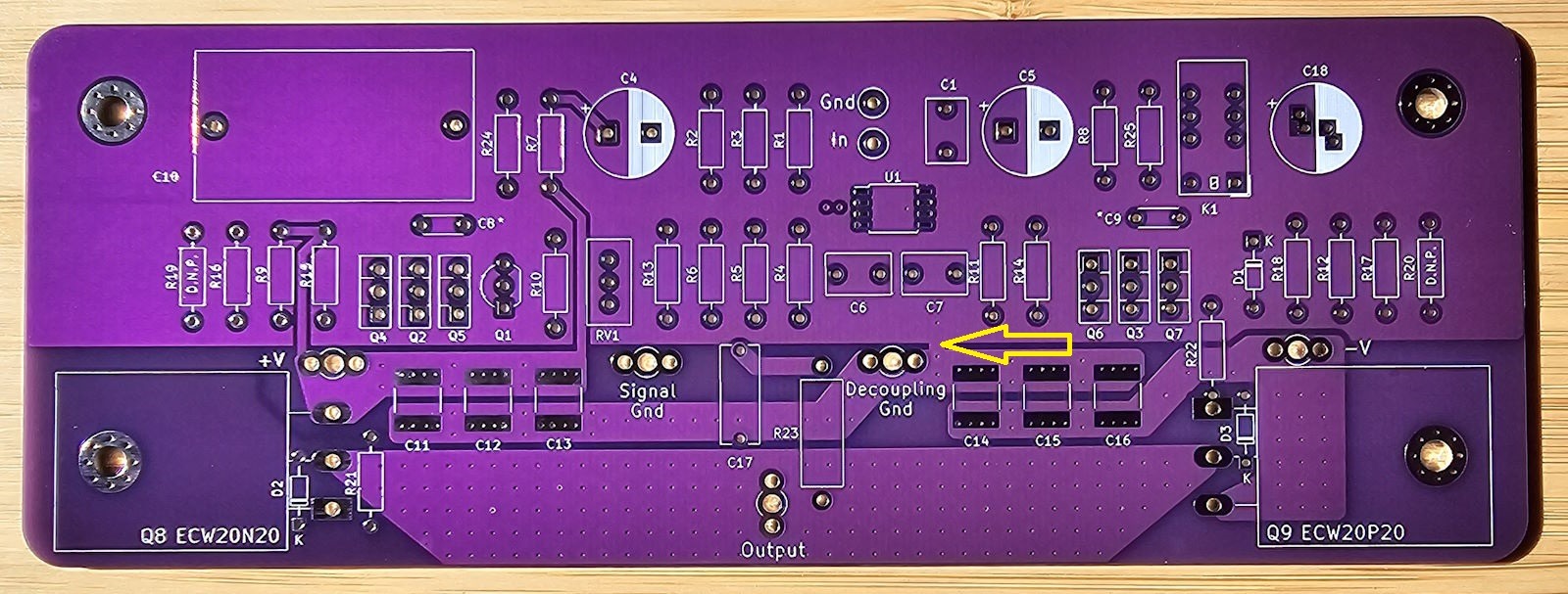

Zero Signal Planes are PCB copper pours, which are connected to the ground at a single point. That way, there are no loop areas which could add EMI induced noise to the signal. Only downsides are that you have to use more expensive 4-layer PCB and there will be higher parasitic capacitances between signal tracks and ground.

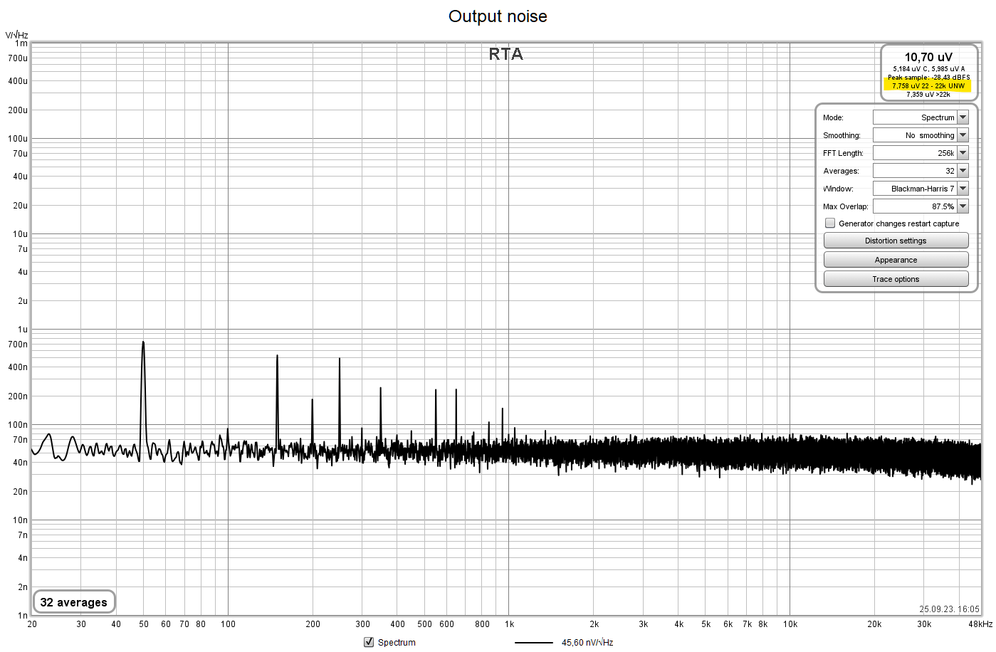

Here is an example of output noise from my latest amplifier (measured with calibrated LNA), that will be published here in a week or so. Mains transformers are some 10 cm apart from the signal tracks, yet induced 50 Hz noise is only 700 nV.

Considering that given example measurement is form the power amplifier with two 120 VA toroids in a cramped 3U x 300 mm case, 50 Hz noise magnitude is order or two lower than with standard design. In this design, PCB layers 1 & 4 are used as ZSP and inner layers 2 & 3 carry signal tracks.
On the PCB picture, single front plane connection is marked with arrow.
I should have it, it’s my design. 🙂
I will publish project soon. This is a 10 W class A, 2 MHz power bandwidth amplifier with 0.0000x (actually measured) distortion. But I’m waiting for the Cosmos ADC (in the local customs ATM) to be able to make precise measurements.

looking at the PCB exicons as output buffer, some bjt or jfet as gain stage seems promising
OP amp is for servo? or for speaker protection with the relay?
Not for class A. It’s an usual 1/3 of nominal transformer power used, providing moderate transformer temperature and good load regulation.
Opamp is actual VAS stage. It has JFETs at input and sonically it is better than Toshiba JFET pair at the input. It is my preferred audio opamp – OPA828. Laterals are used as a diamond buffer follower, enclosed in the opamp NFB loop.yes please publish it soon even without measurements!

At +-17 supply, there is no pressing need for loudspeakers protection.

I need to commenton your 1st post. With the xformers 10cm away, I wonder where those -123dBV hum spurs come from.
Since it also shows mains harmonics, which are produced by the rectifying process, it does look like it is due to sub-optimal wiring/routing and not 50Hz radiated.

I assume the secondary wiring with its higher currents is the noise emitter. Minimizing current loops and twisting these wires helps a lot.
I'd give Q8 and Q9 a chance to get fully decoupled rails (especially in this case... a 2MHz bandwidth) by moving the (C11, C12 & C13) to the left and (C14, C15 and C16) to the right. Then, you'll have enough space to place the +V ingress point close to the Signal Gnd, and -V just underneath the Decoupling Gnd. You'll still have enough copper fill on L1 and 4 (do 2 rows of little vias... maybe..?)
