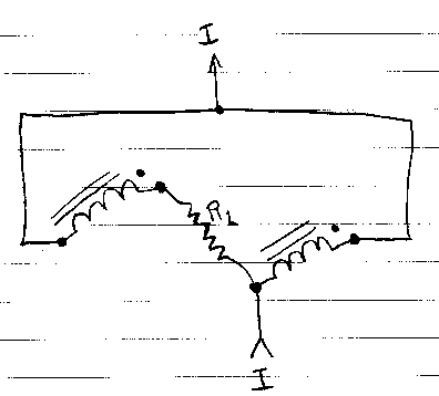

I just did a little visualizing to see how this circuit works. ( see attached diagram) I tilted the components to indicate the voltage levels when one tube puts AC current through it. Tilts the other way for the other tube.
Appears to work fine, but it does EXACTLY the same thing as a normal circlotron with the feedback resistor (R5, R6 ...) values shown. The feedback resistors reduce the grid-cathode voltage by half from the input. The normal circlotron likewise subtracts (by series subtraction) half the total output from the grid -cathode voltage, ending up with the same gain and same signals on the triodes.
As Dave suggested, the inductors really don't want to be bifilar, as they have half the load voltage across them at each corresponding point.
Assuming that the "supersymmetry" aspect is related to taking balanced feedback from both differential output polarities back to each active device input, the normal circlotron circuit already does this too.
Only advantage I see is elimination of the DC grid bias voltage from either the input or the output so no coupling capacitor is needed. But the signal is still passing thru the power supply capacitors.
Don
