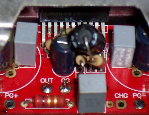

Its LM3886 56k/1k/47uf + full draft input circuit of 56k 2.2k and 4.7uf (warm sound version), plus an A25k.
All resistors both legs curved on 1/2 watt 5% carbon for smooth goodness, much bass, no DC signal in, and no DC output.
Um. . . all at 45 degree angle, both 56k's face the chip.
Its like scads more power. Tube sound anyone?
This mod was necessary because it avoids setting off the Spike when I want to jam.
Supply is 40+40 DC and chip has Artic Ceramique with massive heatsinks.
I already had the "too much" transformer, so I had to use LM3886.
It was a Technics 5370 that was worn out. Then I bought the kit and there was a unlevel frequency response (screeching midrange), no power, no bass, and too much DC out--more on one side. Not an upgrade at first. But now with a beautiful warm sound, thanks to all that carbon and some tinkering. 😉

OK I am looking in putting DC blocking caps but I am trying to avoid electros. I was thinking to try with some green caps (met-polyester) of 10uF. They are big but I could fit am on the Brian's board (...all around it).
Also I would use 1k resistor instead of 680ohm that Brian supplied. That cuts the gain from 33 to 22 and produces filter frequency of 16Hz. Is this too high roll-off and are green caps any good for this sort of a job? ...or am I better off just putting standard electro of 47uF and sticking with 680ohm resistor?
This applies to LM3886 and its stereo sister.
NFB 56k, 1k, 47uf.
Carbon is warmer sound--of benefit to gainclones.
Raising the gain by decreasing the loadwork improves the bandwidth response.
The 47uf cap included with Brian's kit, is quite nice.
Input circuit 56k, 4.7uf BlackGate.
This amp chip operates at a particular speed whereby it needs a matched up layout between NFB and input circuit.
56k's increase gain, increase bandwidth, and lobotomize Spike (power limiter feature) so that he's not so eager to cause clipping.
The in-series resistor, carbon, from 20k to 280 ohms, can be added to the input terminals because it will be fully sheilded by the nearby signal ground line. This is a sort of gain adjustment, in addition to your volume control selections.
The tested value is 2.2k. That's particurlarly recommendable because it matches up.

decky sees the light:
I did put Brian's 47uF electro. I could not say there was a huge difference with and without the cap, apart from a non existent DC offset.
Very good. You will notice a huge difference when the dog suddenly unplugs the input with everything playing at full volume -- with the capacitor in place, your speaker cones will not go flying across the room and break Grandma's heirloom vase -- a very serious form of distortion.
PLEASE pass the word to other novices, decky: DO NOT build gainclones without Ci!
Doesn't the input cap already block DC? I've built mine and i plug/unplug it "live"* and i can't tell the difference with or without Ci.
Edit: *I know i shouldn't do that 😀.
Edit 2: I have a 100K resistor from input to ground plus the 47K one at the other side of the cap.
