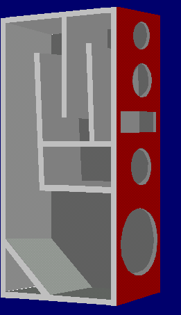

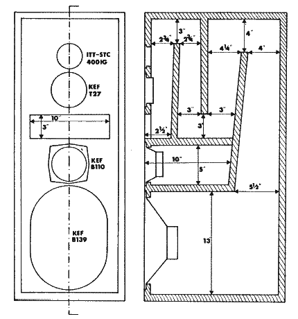

I am currently building cabinets for the PRO9-TL speakers and have found that one of the measurements on the drawing I have is unreadable. The measurement I'm after is from the front of the cabinet to the front partition if anyone has this information I would be very grateful.

Which version of the Pro 9 TL are you doing?
I think this is the more common one
http://p10hifi.net/tlinespeakers/TLS/downloads/Pro9TL-1.pdf
but i have a distribution from Falcon with another variation.

Many thanks for the replies. I'm trying the Falcon version just now but am very new to this game and may try a couple of variations in the future.

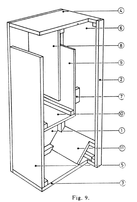

Just surfin today, and came uppon your 2005 message to audio forum . I have a pair I bought 2nd hand years ago and still run (to my wife's regret) They were in black vinyl but I've veneered them in wallnut.
How did you get on building yours?. I re-built mine when I veneered them. (not that hard actually- I used thin pre-veneered plywwood rather than leaf veneer) I also replaced the tweeters at one point when one failed. The replacements were more efficient so I had to stick some resistors in with them.
Other than what Ive discovered by taking them to pieces and listeng to them, I dont know much about them eg what they would have cost, or be worth. I only spotted that they are probably the 'Falcon' format from one of the images replied to you.
