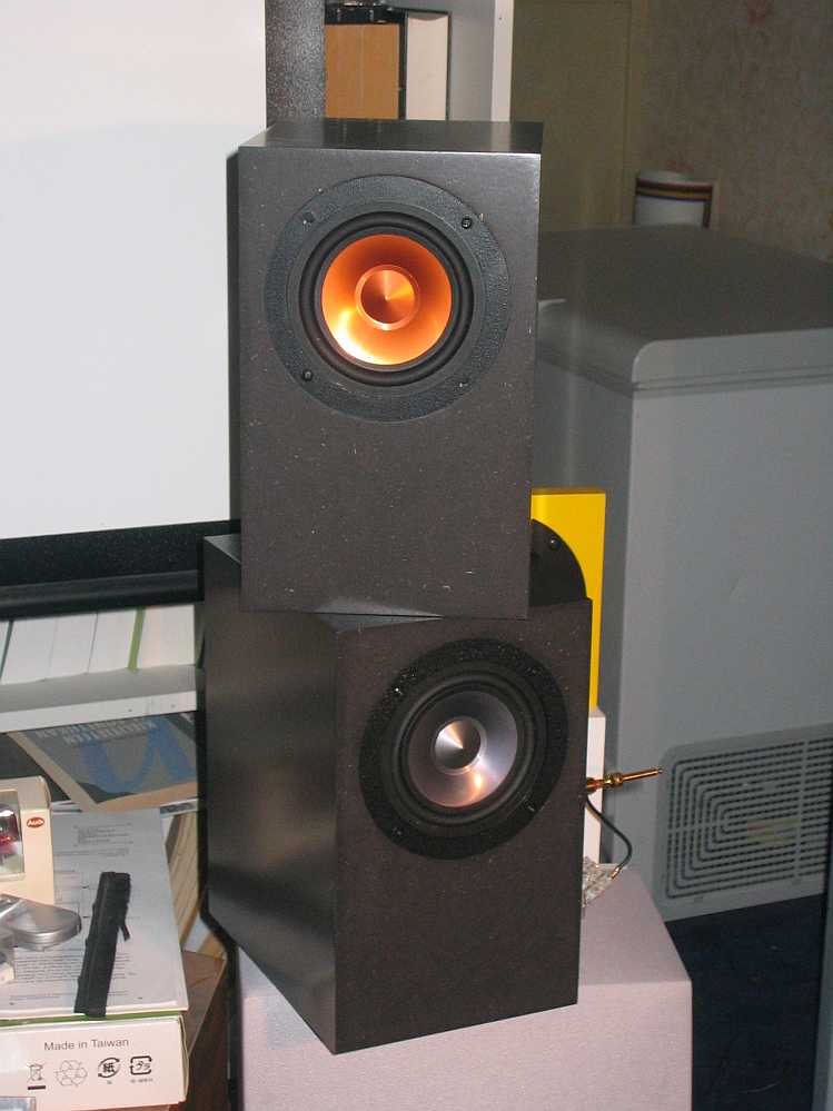

CHR70.2eN in silver (aka grey) or champagne (aka gold)
dave
dave
CHR-Ken

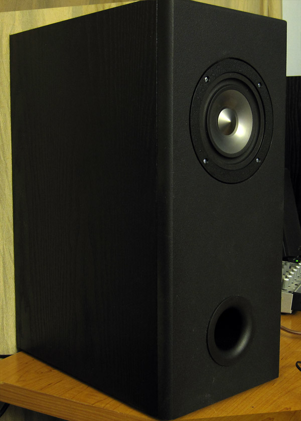

Half Towers with CHR-70.2 - a decent speaker for tight spaces (<5" depth) and listening at moderate SPLs. Easy to build, and a good choice for smaller rooms or as HT fronts. CHR-70.2 bass is surprising, and very clear mid and top. I am playing this with a T-amp.
Good looking job, Zia!
I agree that the chr-70's bass output came as a surprise to me, though I've not heard 'em in your particular cabs.
Best,
don
Best,
don
Don,
Thank you for the kind words. I have the CHR-Kens (as you have) and in my experience the half Towers go slightly lower and have a bit more grunt. CHR-Kens disappear better, and probably have slightly better finesse in bass.
