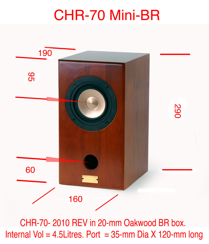

This maybe of interest:
Here's a small BR from Tony, 4.5 litres internal volume, made of re-constituted Oakwood. I'm trying these boxes at home via my 300B (8 watt) amp and Accuphase DP65 as the source.
These boxes are using the 2010 Rev. 2 CHR's. I understand the port is tuned to 66.5Hz, cut-off at 64. I'll put these boxes in the anechoic chamber hopefully in March. I'm keen to measure them since they sound sweet in the lower ranges, more than I'd normally expect for such a small box. This could partly to due to the combination of Oakwood, the warmth of the tubes in the amp and the Accuphase (some consider the DP65 to be warm/softer compared to current Accu's)
No filtering of anykind is deployed as this is part of my assessment of the Rev. 2 drivers prior to the next production run.
