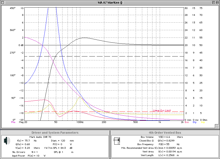

My current plan of record is a 6.6 liter box with a slot port tuned to 55 Hz. That's a compromise between space and low frequency extension.
A little lumpy for my taste, even with the slot port to throttle things back abit. Going to make it harder to integrate with a sub.
dave
The peak is only 2dB, is that really going to matter much? The driver response is more lumpy than that.
That is equivalent to a Q of well over 1.0 which is about as high as i like. Note the big rise in the blue curve -- group delay.
I'd be looking for something rolling off with a lower Q and at a place where i can use it in conjunction with the woofer XO. But that's me. Sealed 5-7 litre gives

Hmmm, if I'm reading that right it looks like excursion becomes an issue pretty quickly as well.
I guess sealed is it for this driver in a box that small. Damn, I was hoping for a slightly more interesting build.

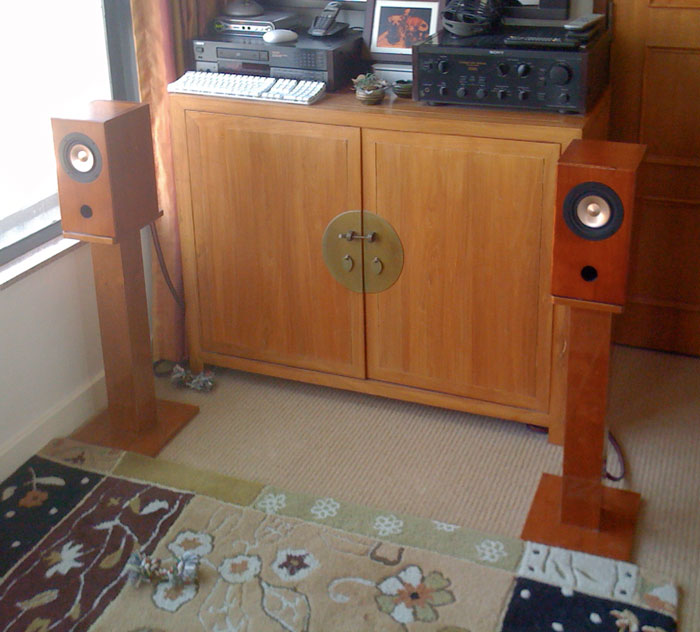

There's plenty of audio guys out there using CHR-70 in smaller reflex boxes with no LF distortion issues under typical load conditions. Here's a pic of a new pair CHR-70 in Tony Wong's Oak wood 5.6 litre BR's. I'm trying these at home in Causeway Bay, Hong Kong. Very pleased with the results so far.
Mark.
