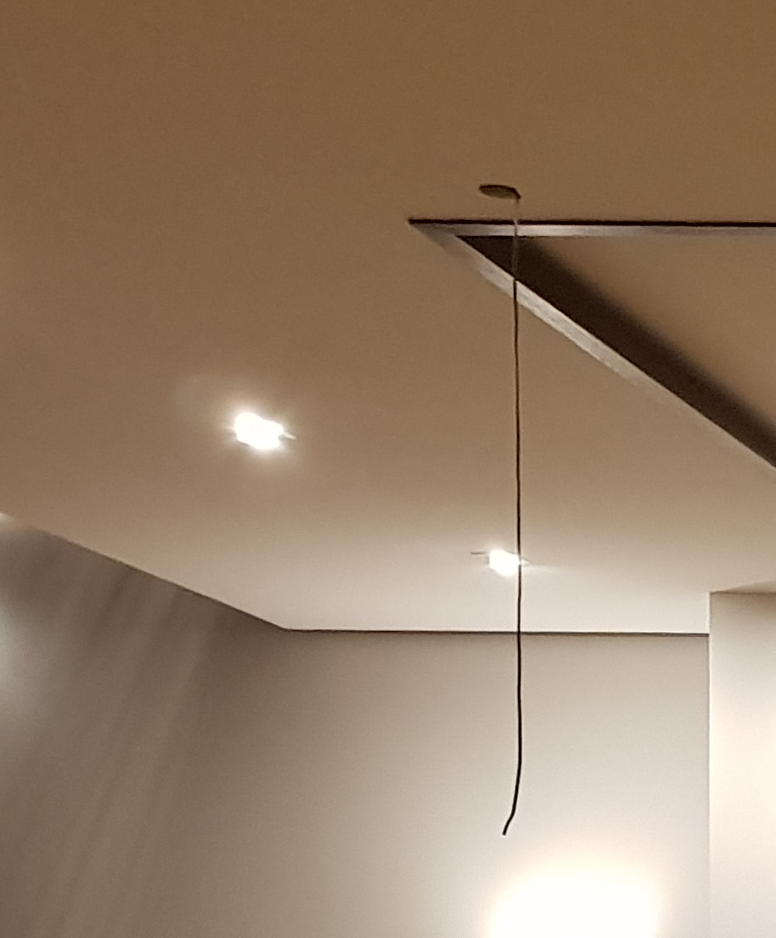

The last thing to choose is a driver/cabinet for two ceiling channels. I'll be happy to mount the speakers flush with the surface. Guys, is it possible to mount a Markaudio driver without any cabinet? There is some 10 cm space between the gypsum board and concrete ceiling.
here's the place for a ceiling speaker
I've never installed a pair of MA drivers in-wall or ceiling, and while the smaller drivers you're considering are certainly light enough that not much structural reinforcement would be required, I think you'd still want some type of enclosure behind the drywall.
