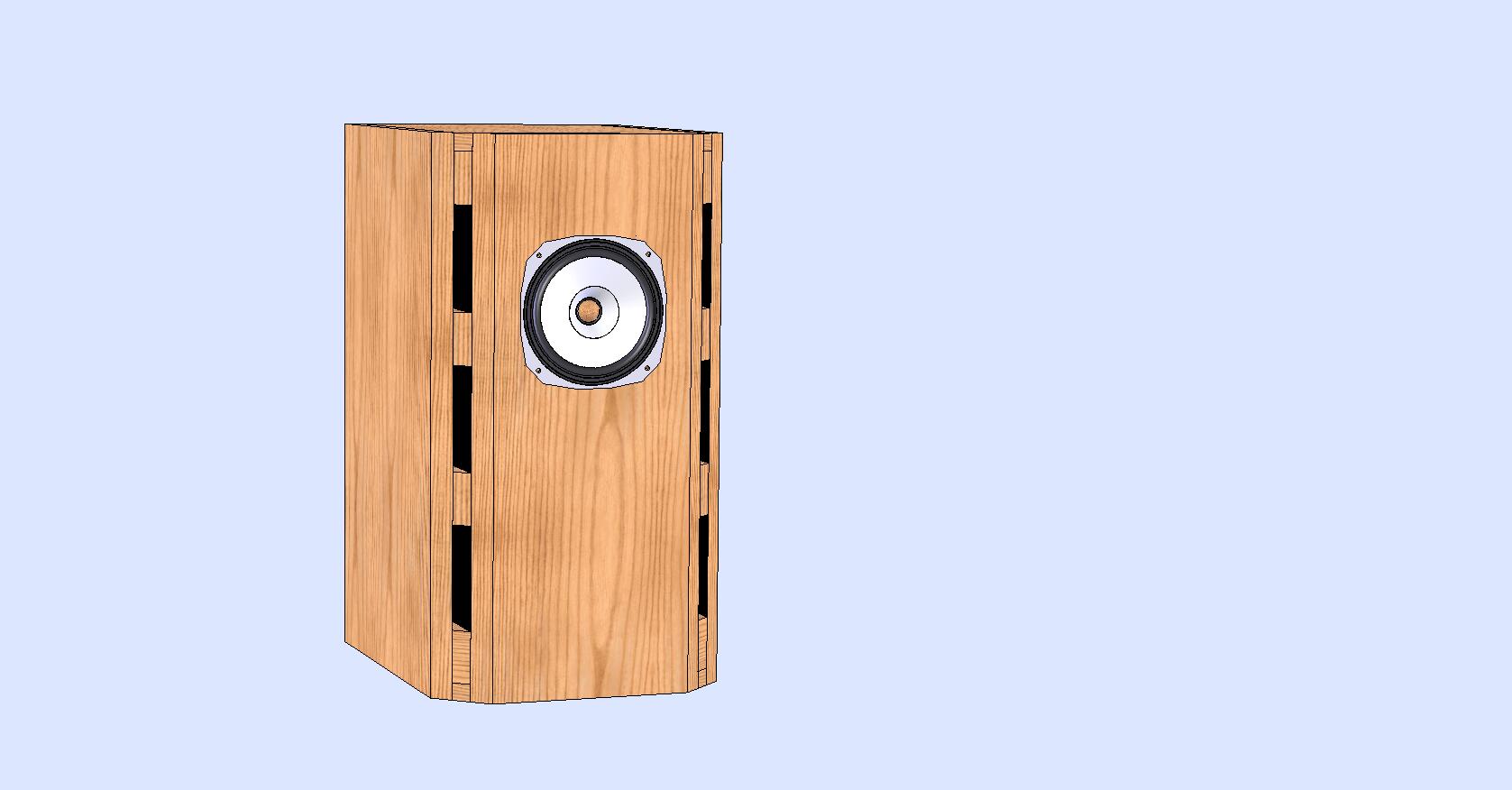

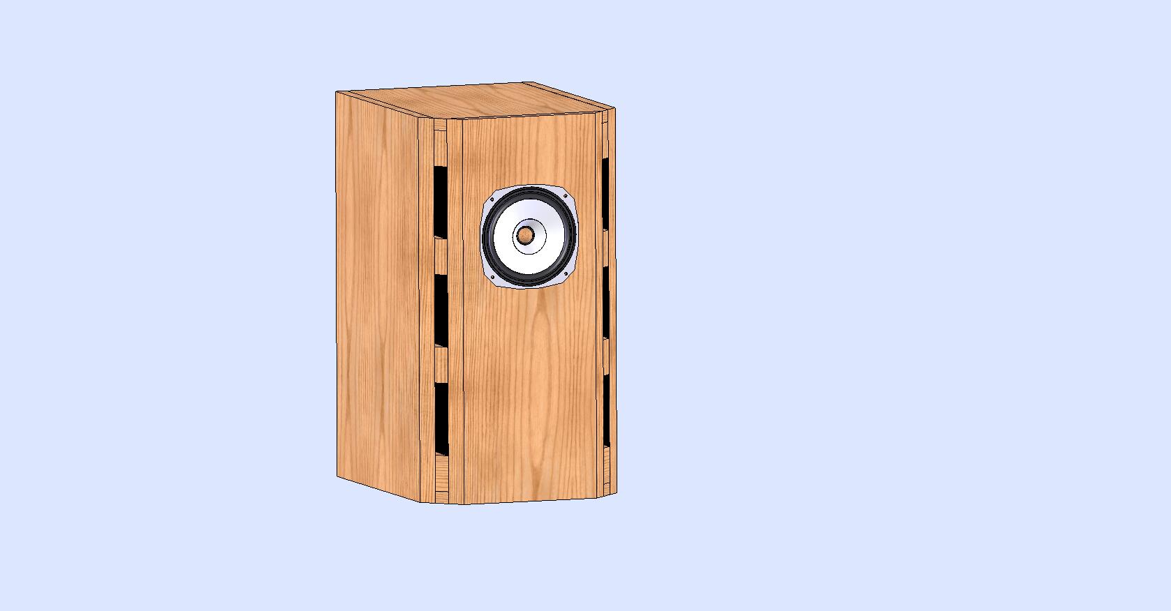

This enclosure works quite well with FE167E, and the topology has proven to be compliant with a range of driver brands and sizes.
It's the same enclosure you inquired about in another thread, and the photo posted there is interior of one of the pair below. The required volume is such that they could be built without the lower void cavity, but then stands would be required , and this way you could include a small woofer per side for a killer active system.
I'm going with the "classic" Fonken style cab for my drivers. Unless I change my mind of course.😉
