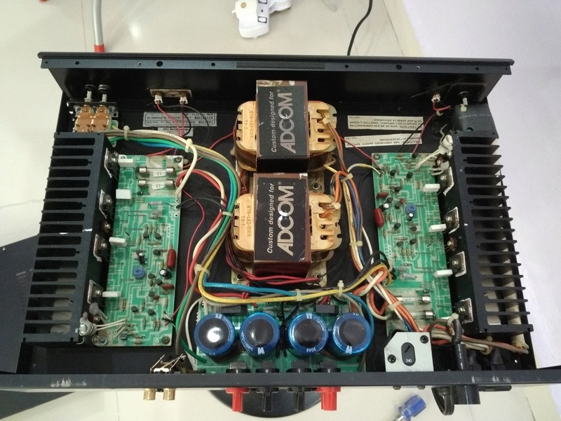

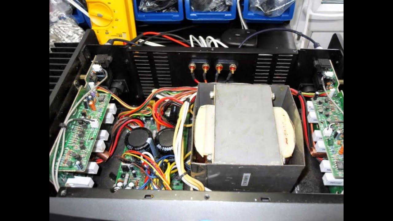

Adcom GFA-535 - 2 pair Sanken- 60V rails - it cranks. (80W+W) dual mono amp. (dual E-core)

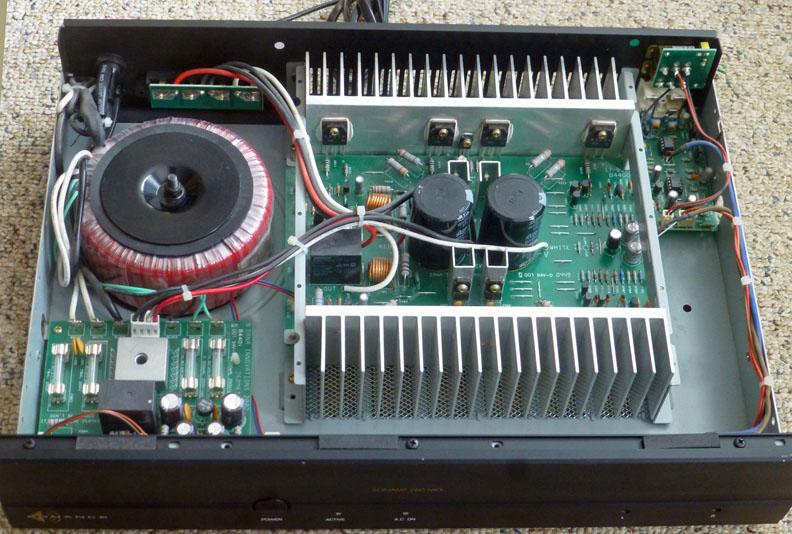

Sonance 260 1/ or MK2 - 2 pair Sanken - 47V rails , good for 2.7R loads (70W)

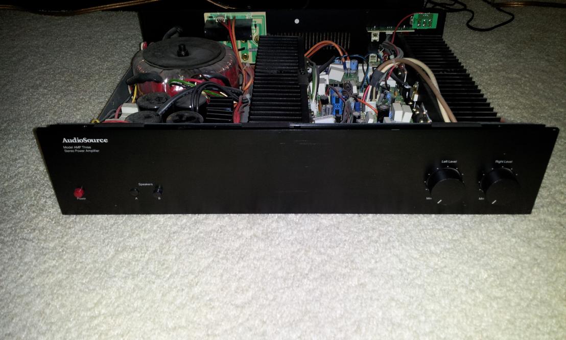

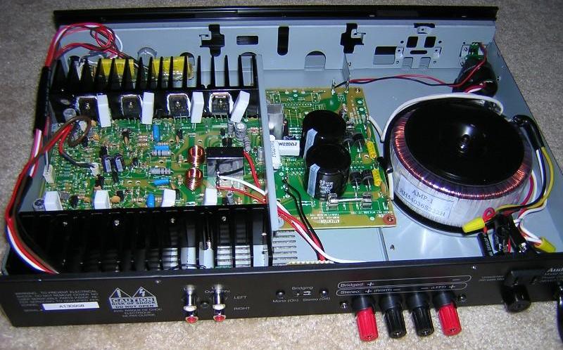

Audiosource amp 1 - 2 pair Sanken - 55V rails , very similar to the Sonance (80W )
Audiosource amp 3 - 3pair (150W). Dual mono with the dual secondary Trafo.
All these amps have the high grade FR-4 PCB's , and the layout is mostly audiophile.
All are Common on Ebay , I've recapped and tweaked all these. The build quality is
WAY better than Sony/Kenwood/Japanese , most other vintage Hi-fi. Simple Hitachi , symmetrical , or LIN amp topologies .
Most are 25-30 years old , still work (a bit rough) , with mostly bad caps.
I don't bother with most cheaper "Vintage" OEM's with the aged phenolic cheap boards or E-core trafo's.
The way these OEM's design hot running cheap regulators , phenolic is usually burnt.

Thanks, that one looks like a nice alternative to the Adcom GFA-555Hafler DH-220
I also second ostrippers GFA 535 recommendation. I have one as my garage speaker amp. It’s a solid option
Interesting choice indeed as working units can be had for around 200USD on fleabay.
Is there a consensus as to which of the Mk. I or Mk. II is best?

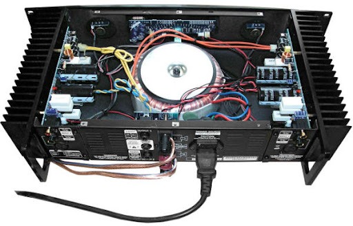

Another amp to look at is the Behringer A-500 (below) . Dual secondary and true dual mono PS with a op-amp IC powered
type input/output stage. I'd put Badgers in that case.
Alesis-ra-500 also uses 3-pair Sanken 125W devices (150W).
I actually don't like the Behringer. NO discrete classic circuit to tweak.

I'm curious, are these pics all restorations you did?
Some of the best (wired) aren't bad at .003% , like some well made "Leach" amps. But a PCB leach is typically 1/10 that - 2-3PPM.That is good to know, thanks.
You most likely Couldn't tell the difference. I don't mind a good .02% amp , as long as it is dead quiet.
Fet's can be tame , 8 years ago ... someone modified the old wolverine output PCB to FET's , add ferrite beads toeah, saw that.... I'd prefer working with BJTs.
the gates and bigger gate resistors , works perfect.
Some of those are my pix. Some are those I want , I'd sell the Behringer as "Behringer a-500 benchmark outputs" for 6-700$
