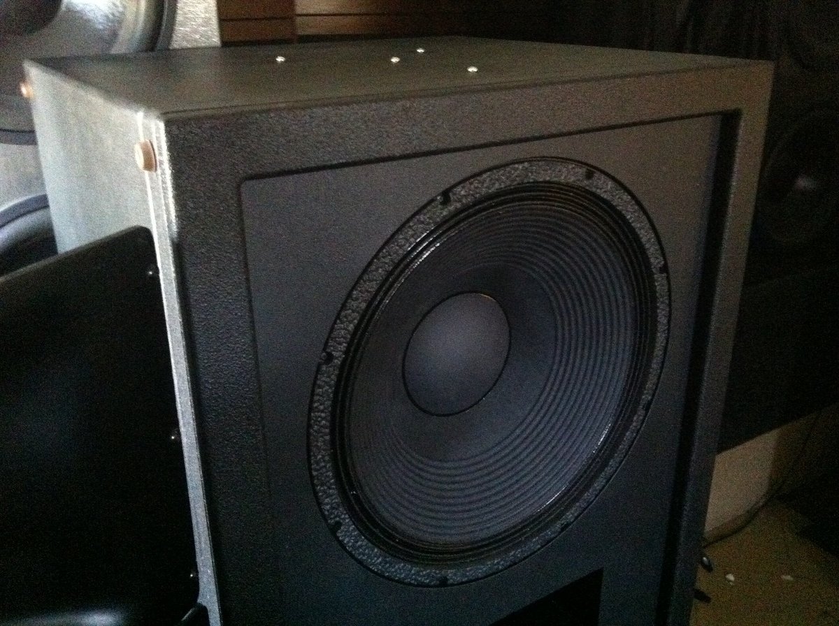

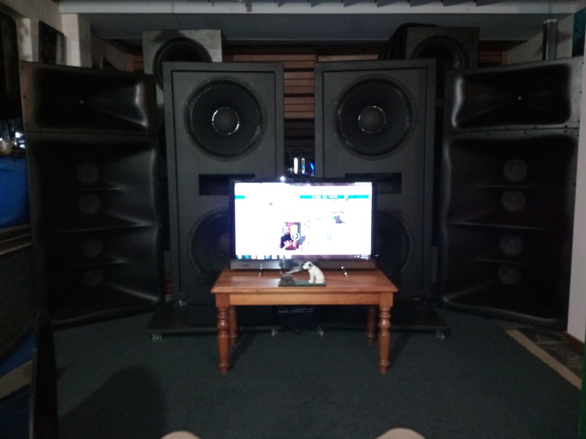

First ever post on DIY, please excuse the intrusion
This JBL Cinema Horn rig is 100dB efficient for the first watt at 27Hz and beyond 1200Hz 117dB efficient with beryllium domes in the JBL Compression Drivers.
To drive to 110dB, 100W, 1 bass unit
For an out door venue, I wouldn't bother with a sub, silly idea as you just soak wattage in infra bass for no good results
The Twin 21" reflex cab's go down to 24Hz -3dB and are perfect for application here
This Rig is an out door field system run from a battery, efficiency is the key to a successful set
15" subs, you are barking up the wrong tree
Just out of interest I run a DMX RGB rig with this, run at a solid 115dB for about 2 amps on 230vac or less than 500w for the whole rig in total (sort of ground breaking stuff and a throwback to the early cinemas)

The paint is still drying on the Twin 21's and I've only had the horns for a month, today just purchased the DSP, currently on a miniDSP. Have done a test Gig
A bit happy to say the least, it's due out to the first gig in the end of March
