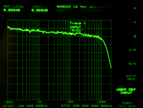

you can make a phono plug which has decent impedance to 150 MHz or so -- it takes a little bit of 5/32" brass tubing and RG-188 coax -- http://users.easystreet.com/w7zoi/rca_plugs.html
if you aren't going to roll your own connector with an RCA plug and brass tubing -- this is the effect of one RCA phono connector from 100kHz to 200 MHz -- the trace was normalized at 50 ohms -- the vertical scale is 0.05dB/interval.
