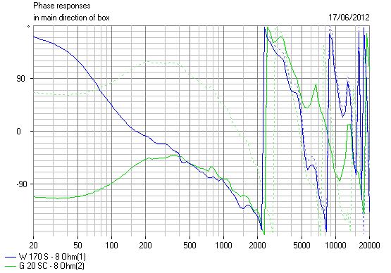

Oddly enough, some combinations of woofer and tweeter are particularly tidy. 6.5" paper woofer and dome tweeter is a nice one to work with on second order. 5" woofer and dome tweeter works very well with a third order on the tweeter because it has good phase alignment at crossover. I'll stop there, having left you a goodish performing example to ponder. Notice the 6dB rolloff at crossover, which says phase is OK. Also that the slopes are similar.

It might be best to say you won't go wrong with a Linkwitz-Riley slope, and fourth-order seems to come up often. The slope you get will be a combination of the driver's natural goings on, and the filter you use so unless you measure things you won't be certain. Not that this on its own will lead to bad sound.

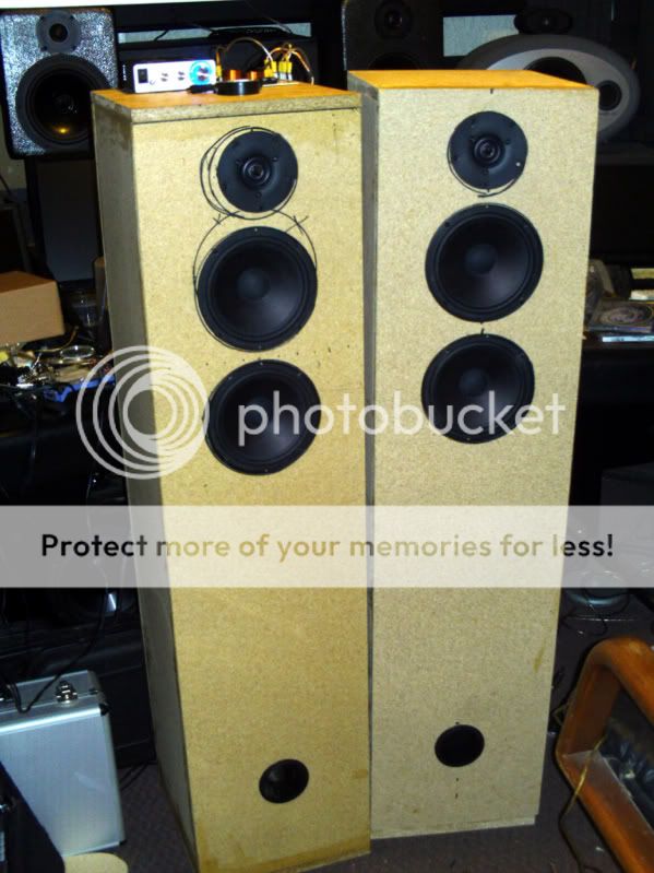

My rule of thumb for woofers in bookshelves is you give it a bafflestep coil equal to the Le inductance. The rolloff capacitor is then Le/ (Re squared) times a fudge factor of 0.666. Naturally this works best with low inductance woofers to get a reasonably high crossover point. I'd then model it to get it just right. Floorstanders and the HIDEOUS bafflestep correction is so laughably WRONG that I won't waste time on it. Er, just my opinion. 😀

So you're going to parallel the woofers and hope the tweeter can keep up with the loudness. How are you getting on? What are the drivers?
Yes, paralleling the drivers to 4ohm. The tweeter is 4ohm so it matches quite well. The amount of bass I'm getting out of these is wonderful.
Cheap drivers... I have them crossed around 2k, 2nd order Bessel atm
Focal 6M115 6-1/2" Midbass Speaker 299-155
Vifa XT25TG30-04 1" Dual Ring Radiator Tweeter 264-1016
